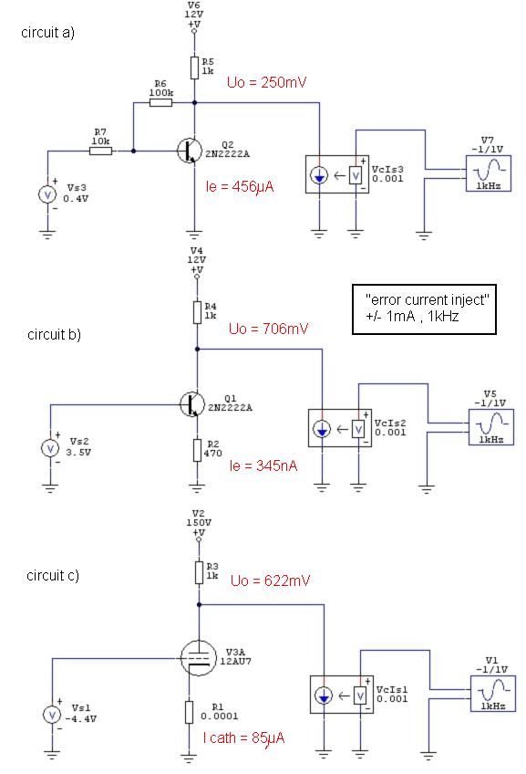

A little experiment
Once again, it was not my intention to open up the never ending feedback story again, nor do I want to hijack this thread, which is originally about Nelson’s paper from 2008.
From my point of view, his paper is very accurate and well written as ever. It sums up what is common knowledge and good practise in audio engineering. I always enjoy reading his articles. I hope it was not an infringement of the majesty by pointing to an article I wrote mainly for customers.
Now to the controversial story:
Most, if not all available textbooks call the emitter degeneration circuit “current feedback”. There is no doubt about it. By repeating something again and again it is not getting better. The name has historic reasons and we should be a little more cautious using it. Current feedback operational amplifiers like LT1223 carry the same name, but work with a real feedback loop.
The name “current feedback” for this circuit originates from the following considerations:
A rise of the input voltage causes Ube to rise; Ic increases now; at the same time the voltage drop over Re increases too. The rising voltage on Re counter acts with input voltage, leading to a decreasing collector current Ic. That’s what is meant by feedback here, I am pretty clear about it. But this is not a classic feedback loop, it is just the action of the transistor trying to satisfy the equation
Ic = Is x exp(Ube/Ut).
You may call it the inherent feedback of active devices. Because it is inherent, it is very fast in contrast to loops which comparably slow.
Perhaps a little experiment can help us here. Please take a look at the three circuits a – c) All circuits work with quiescent current of 6mA, a collector (plate) resistance of 1kOhm. The output voltage of each of the three circuits is “disturbed” by injecting an error current of +/- 1mA or 707uA rms. In the real world, this error current may originate from an altering base current of a heavily load BJT stage connected to the output. A feedback loop would try to counter act this disturbance. Circuit a) does the expected; we notice a correction current of 456uA (rms). Circuit b) is doing nothing to counter act. The resulting emitter current is 345nA (rms), 1300 times lower than in circuit a). The very small fluctuation is due to the Early effect. Circuit c) is a vacuum tube ECC82 with an inherent feedback. This feedback effect is called Plate resistance. From the numbers it is easy to calculate an Rp of 7.3kOhm which is roughly what you find in the datasheet of this tube.
Once again, circuit b) shows no reaction; it is not a classic negative feedback loop.
Q.E.D.
A last word to the degeneration / transfer curve story. You won’t find a statement in my paper, that degeneration is not altering the transfer curve of the amplifier. This would be a silly implication.
Of course b) doesn't react as you are injecting outside the feedback circuit.
If you would inject in the feedback circuit, like in the emitter, you WILL have a reaction because you are now disturbing the feedback circuit. If you do that, you will see all the classical events of a reacting feedback circuit.
Anyway, I think you make an artificial distinction between a 'classical fb loop' (whatever THAT is) and the local feedback provided by an Re.
jan didden
