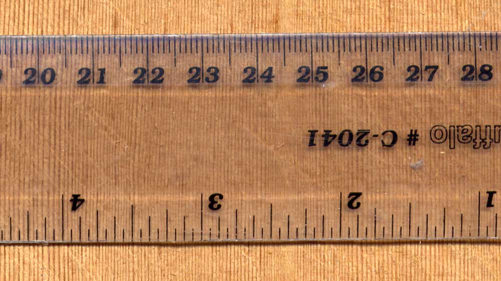

I had a 100 year old house in Sweden in which I knocked down a wall. It was built of two inches thick, 100 year old pine. The boards were 10 times harder than the gene manupilated, fast growing Pine that are planted in Sweden today. Of course time makes it harder but the forests are not the same today as before.

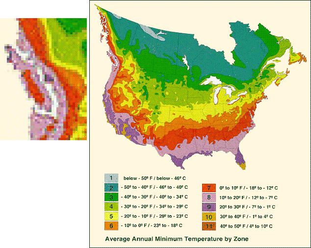

Hmm, 25 Year rings/inch. Were talking high altitude growth/climate zone 5-6?

peterbrorsson said:Were talking high altitude growth/climate zone 5-6?

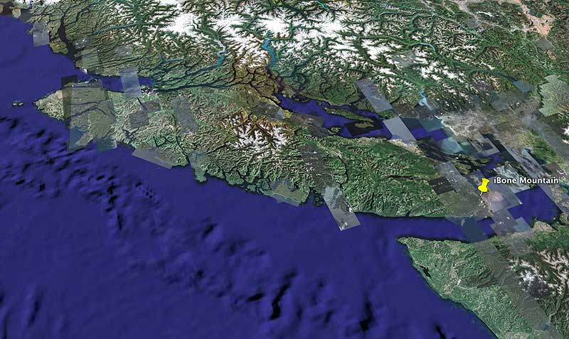

Vancouver Island doesn't really have any extreme altitudes (it is thou the top of a mountai range sticking out of the pacific ocean with all the attendant fiords & such).

planet10 said:Vancouver Island doesn't really have any extreme altitudes (it is thou the top of a mountai range sticking out of the pacific ocean with all the attendant fiords & such).
Highest peak is not quite 2.2 km (http://www.peakbagger.com/range.aspx?rid=1203). Attached is a snapshot from Google Earth -- i expect that this peak is in the snowy part and that Scott's wood came from near where he lives which is on the cost above the snowy peaks right to the left of where the water starts opening up.
My place has the pushpin and my chunk of wood came from right across the fiord below me on the map. (probably 400-600 m elevation -- i'm at about 245m on the side of Mount Finlayson, and the fiord is called Finlayson Arm)

It does not have to be high altitude. It depends also on the climate. That's why I put / in the question.
I come from the "south" of Sweden, relatively speaking, where the pine is growing in sand soil. This is also a highland plateau. Veeryy slow growth, beautiful and easy to stain!
The South European pine is just awful if one gets lowland pine. I have seen examples in my work with 1 cm summer wood!
High altitude on a North slope is another matter.
4-600 m is ideal for pine anyway. Still get some lenght combined with slow growth, voila excellent wood.

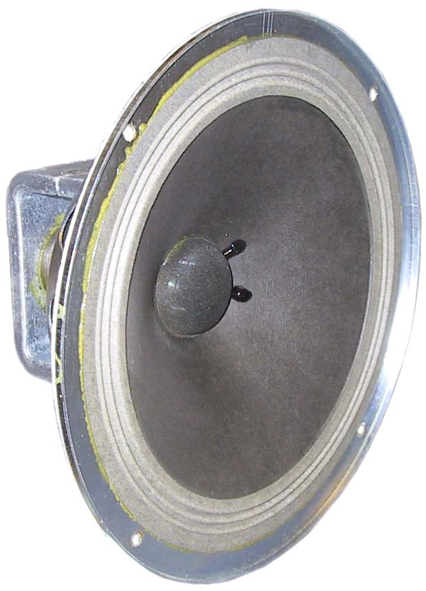

MJL21193 said:Dave: A little off topic again, but I noticed on your site that you deal vintage drivers. I have a pair of 8" woofers from a pair of Criterion 77 speakers. They are in pristine shape. Do you have any experience with these? I measured the T/S specs, and wasn't impressed. They are as follows, both drivers measure within 5% of each other, this is the average:
Fs - 107 Hz
Qms - 7.5
Qes - 2.3
Le - .52
Re - 6.3
I was thinking small OB, with that impossibly high Qes. Any ideas? Trash or Treasure?

MJL21193 said:Dave? No coment? Anyone?
Sorry missed that post -- trying to get some work done here (phase plug install for a customer with Visaton B200s from Omega).
Those are considered gold. Especially if they are alnico. A Coral OEM. You measured parms are within experimental (and age) error.

Do you have the ones with the holey basket or the ovals? Did you also rescue the other drivers? The superTweeter is quite unique.

Thanks for the good news.
That's my driver in the picture, except the magnet assembly is standard ceramic puck ~ 150 grams. Also basket has oval holes.
I only have the woofers., but they are in amazing shape, no signs of distress. Cool mess dustcaps.
I was thinking OB from the measurements, any ideas on baffle size?
EDIT: Sorry didn't look at that link you posted before writing this. Baffle is a good size, not keen of a coaxial tweeter arrangement though. Screw up the image if it's mounted above?
