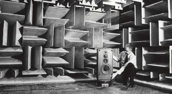

What I'm going to suggest assumes 2 goals and I'd also guess this would probably be most applicable in an acoustic suspension design.
Goal 1) Prevent sound energy generated by the backwave of a driver from reaching the outer surface of the enclosure and thus radiating into the room.
Goal 2) Prevent sound waves from leaking back through the driver membrane and radiating into the room.
What about building a miniature anechoic chamber inside a fairly rigid and well braced enclosure made from baltic birch, mdf, whatever...? Would that science be scalable to work inside an enclosure at some level? Not suggesting it would be perfect but it may be an additive solution that would enhance the properties of the base material used in constructing the enclosure.
I'm thinking the triangular shapes could be manufactured from a non-exotic material. They'd need to store the sound energy and release it extremely slowly as heat. I think that is the basic principal in the full-sized chambers. Cork? Balsa? I guess you could use something like rigid fiberglass, but making all those--that is getting dangerously close to dollhouse territory.
This might also be like the box inside a box theory, but this inside box could have a vastly larger surface area exposed to the sound energy on the inside. Would that provide any benefit?
Any type of vented speaker wouldn't benefit from total absorption of the back wave, as this is used for bass reinforement. A sealed box should be ok with it, but my own experience with stuffing in sealed boxes (which would be a close second to anechoic ) is that it can make the bass sound muffled. I prefer to cover the insides with rubber-backed commercial carpet. This carpet has good damping properties when adhered to the panels. The difference I hear with this is probably in the higher bass region - above 100Hz.
liasom said:Goal 1) Prevent sound energy generated by the backwave of a driver from reaching the outer surface of the enclosure and thus radiating into the room.
Pretty much B&W's goals when working on the Nautilus....

MJL21193 said:A sealed box should be ok with it, but my own experience with stuffing in sealed boxes (which would be a close second to anechoic ) is that it can make the bass sound muffled. I prefer to cover the insides with rubber-backed commercial carpet. This carpet has good damping properties when adhered to the panels. The difference I hear with this is probably in the higher bass region - above 100Hz.
I've also heard the muffled sound to varying degrees in stuffed enclosures. That is why I'm thinking to find a way to entirely get rid of stuffing, foam, carpet, etc. in a box shaped sealed enclosure. I have a project in the works requiring small sealed enclosures and am going to try a semi-anechoic idea on a test enclosure. My plan is to make the shapes less deep than those used in the big chambers (see graphic, like on the right side) and to either glue the shapes on only 3 sides--back, bottom, and either left or right or to place them less densely so as to cover about 40%-50% of the interior surface. Probably the latter approach since it might slightly help dampen panel resonances with a bunch of small "braces". I suppose the challenge is to find the right balance. It is so easy to over-dampen an acoustic suspension design. Still investigating to find an appropriate material though.
I figure it's worth a try.
You might like to try a method that Dave Berriman used in several of his designs - a sandwich (3) of hardboard stuck together with Evostick and with the rough surface towards the drive units. These were very effective.
Talking of whom, does anyone have a copy of Hi Fi News and Record Review with the article on building his floorstander (DB8 I think) circa 1998. I got a mention in the article but made the mistake of lending my copy to a friend and I never got it back.
NOW you have my interest. The idea is taking shape in my head.
A multitude of triangular prisms cut from MDF, glued to the inside panels, in sets of 4. Then a set perpendicular to the first, and so on in a checkerboard pattern.
I wonder how effective it would be? Would certainly strengthen the box panels also.
I have a sealed pair that I'm currently working on that I might try this method. My original plan was to for a constrained layer with the 5/8" MDF on the inside and 1/2" veneered particleboard on the outside with silicone rubber as the adhesive. Then rubber back carpet on the inside to reduce and disperse standing waves.
VERY worth a try.
