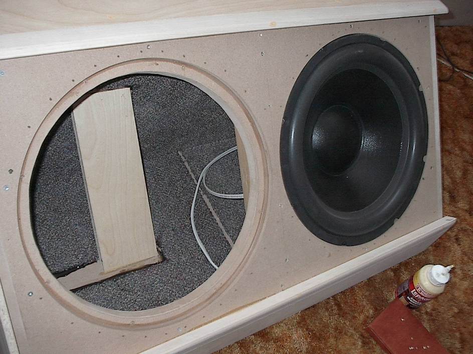

Not at all. The orange shag is on my floor , not in my boxes. I have commercial carpet tiles with a rubberized plastic backing(not the cheap foam rubber).
As you pointed out earlier, low frequency sounds have long wavelengths. There are not many materials of the thickness required to absorb these waves that will fit in a modest sized box. So, when I say standing waves, I'm talking about the waves that can be interupted by this material.
Here's a pic of both the shag and the damping material:
Gotta be fair to you. Just looked at your pic. That's a nice well built cabinet.

MJL21193 said:I have commercial carpet tiles with a rubberized plastic backing.
It is the rubber backing that acts as a panel damper. Commercial carpet fibres will have little air space damping and will have little affect on standing waves. And in a subwoofer of that size, it is unlikely that any box dimensions are large enuff to get excited by the subs bandwidth... what XO frequency are you using?
