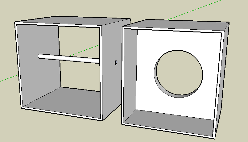

I have to respectfully disagree. The rod approach just joins the two surfaces together so they resonate together. It does nothing to minimize the resonance. To do this you need to triangle brace with a rod from the cetre of one panel to the centre of the adjacent.
Easier way is to us a full panel bisecting the space down the middle, from side to side which will brace all sides.
A brace like this would go a long way:
And I respectfully counter disagree. The rod forces the two walls to be one at the center - the oak is virtually infinitly rigid. So if the two walls move together their stiffness has doubled and the resonance WILL go up. But the critical factor is that the two walls CANNOT move apart which is the way that the pressure in the box is trying to move them. In this regard the resonance goes WAY UP - far more than what you have shown. Yours solution is not even remotely effective to an interior pressure mode. While what the 2nd guy posted would work OK from a stiffness standpoint its acoustic effect would be very bad - I would never do that. MDF or plywood is very weak in compression - its a terrible brace material. Almost no wood products are any good in bending - which is why they need to be braced - but natrual woods can sometimes be very good in compression (like oak which is supurb) - that's how trees grow!
And you ignored the part about joining two or three rods at the center - now they can't move in ANY direction. Net result - enormous lowering of cabinet wall motion with very little added weight or loss of interior volume. There simply is no more effective method of stiffening than this - trust me! (or don't I don't care.)
MJL21193 said:
You are only looking at the sound pressure, not the mechanical from the driver itself.
The full panel brace will outperform the rod. No question.
And here again I have to disagree. The mechanical force due to the driver is very small compared to the pressure force from the driver. The mechanical force is the reaction force from the cones motion, but the cone has almost negligable weight compared to the mass of the encloure - there will be very little force transmitted in this manner. But the interior pressures can be enormous over large areas - this force can be very large and simply dwarfs the mechanical reaction force.
But this too I deal with by simply making the front baffle two pieces of MDF 3/4" and 1/2" glued together with a well damped glue. The baffle doesn't move from mechanical forces and the walls don't move from pressure forces. Thats what an enclosure is supposed to do.
Again, with all due respect, you don't seem to be seeing the picture here. Triangular bracing (on it's own or in the form of a panel) maintains the 90* angle in the corner. The rod approach doesn't. The panels will move in unison, that's all.
It's not compression forces that are being resisted here, but tension.
I didn't ignore it, it doesn't improve the situation enough.
Why check one and not the other? Better to be sure and cover both, than to ignore one completely as insignificant.
The full panel brace does this easily.

Why is it that when I disagree with you I'M NOT seeing the picture. I think I see the picture, I know I see the picture, and I still disagree with you.
You are obviuosly NOT an engineer. Compression and tension are the same thing!! Just different signs.
Fixing the rods at the center is extremely effective - "your not seeing the piture here".
Why do something just to do it? Thats just a waste of time, materials, cost, everything - if it doesn't make a difference why do it?

"So a single Oak rod (maybe 1") across the enclosure will do more than many time that amount placed on the walls, and there is NO interior acoustic effect."
Thanks Earl
I have used the oak dowels used in closets to hang clothing on to good effect in a couple of my boxes. Made a big difference before and after. I crossed them but didn't tie them together. I didn't think the dampening would do all that much. Thanks for the tips.

When I say "tie them together" I mean glue or bond somehow so that they can't move - there won't be any damping. Think about this structure - it forms the basis of almost every structural component that I know of - Bridges, space stations, you name it.

I agree with gedlee on the effectiveness of using the rod. For enclosure surfaces to resonate together as you have mentioned, the mass distribution of the total enclosure must meet quite specific conditions so that the net force will be zero to keep the box stationary.

Do a simple, cheap experiment. Take a cardboard box and cut the top and bottom out of it. Now use a dowel to join the sides together. How strong is this structure?
Now take another piece of cardboard, one big enough to fit inside the box so it touches all sides. glue this in so it bisects the space.
If you actually do the experiment, you will find that the full panel makes the structure MUCH stronger.
Forget BS about mass distribution and net force. It's simple building science.

This is not the correct experiment. Its biased to highlight the advantages of your approach. Put two rods across the box and glue them at the center. Now which one yields the most strength for weight and volume of the stiffener? And when you use very flimsy materials then the stiffness increase does not show up for the rod as well as when the materials are stronger. You need a fair test to make judgements from.
