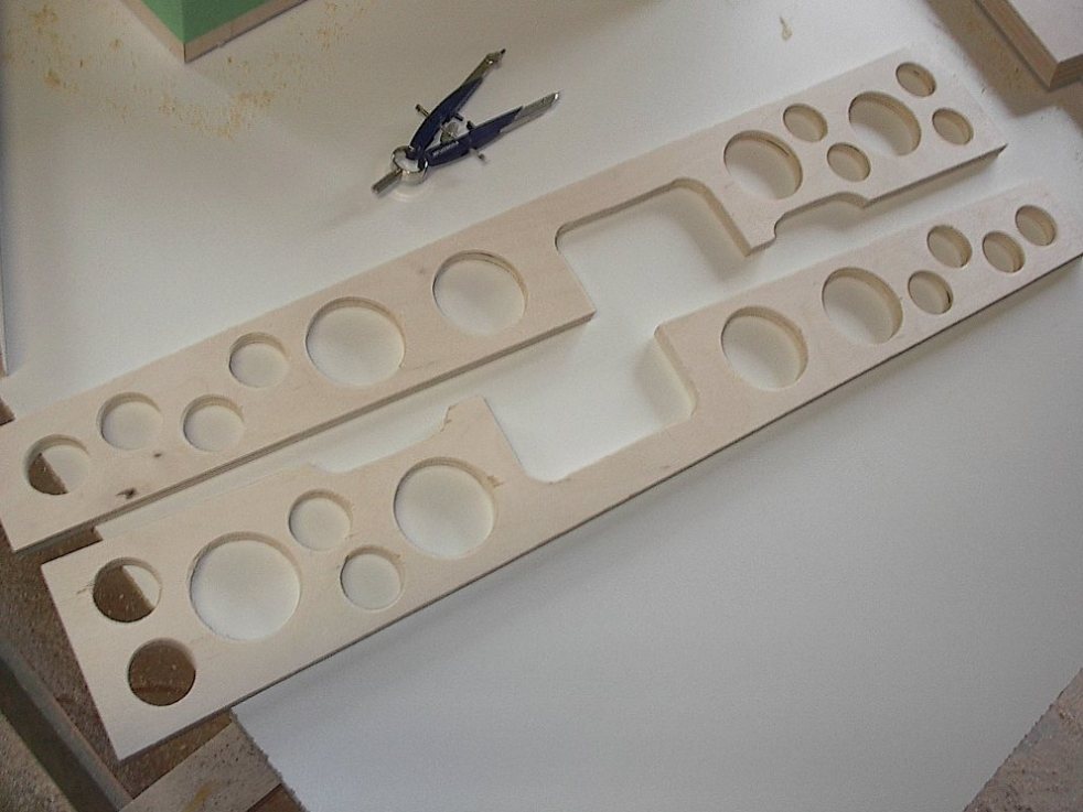

MJL21193 said:to cut holes in a piece of plywood is not a big deal.
Not a big deal, but in our builds often one of the most time consuming bits (cut the holes and then champher them all)
dave
dave
Hi Dave,
It doesn't need to be pretty to work well.
While the chamfering or rounding over certainly makes it look nicer, it is not strictly necessary. This is not ductwork where air flow turbulence will be a factor. If the rear of the driver is not close to the brace, there shouldn't be air noise problems.
These were cut with 2 sizes of hole saws. The compass is for visual appeal only.
