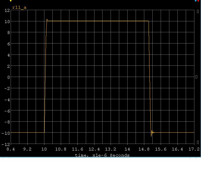

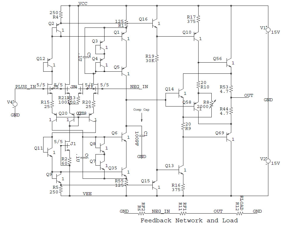

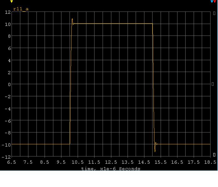

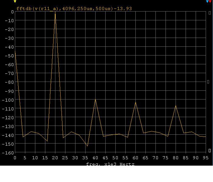

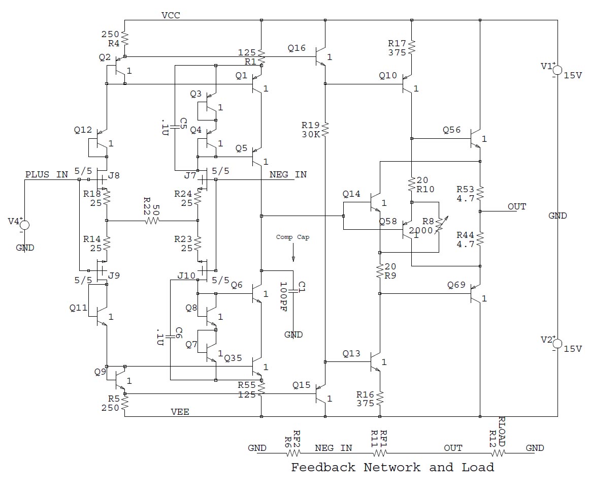

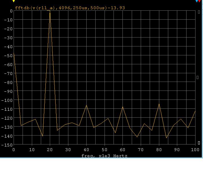

I just love it when Scott puts up a circuit! This refinement on the first is a Very nice blend of volt and current feedback concepts. Still flexible re adjusting open/closed loop gain for DIY'ers to play with to learn about that issue. I was happy with the first design put up. Now this! Its getting dialed in... wont be long now (?) and we can build something. Thx -RNM
What seems to be lost here, is: WHAT IS IMPORTANT? Of course, many discrete op amp design ideas were developed more that 40 years ago, but not all! The OPTIMUM designs are usually elegant, as well as relatively easy to source parts, etc. Unfortunately, then the OPTIMUM design changes with source availability, as well as added circuit tricks.
What is important is how linear and/or how quiet the circuit is, how fast, etc.

What do we assume for source impedance?OK here is the Rush cascode version 200V/us into 600 Ohms not to shabby.

Scott,
Being a complete newbie here and trying to follow what I can here I'm am lost as to the feedback circuit. Where does the r6 and r12 get in the circuit?
Just connect the node labels, I am trying to make the schematics easy to read without a lot of crossing wires.
I know that's an issue, but it's good to start at a baseline and work from there.
