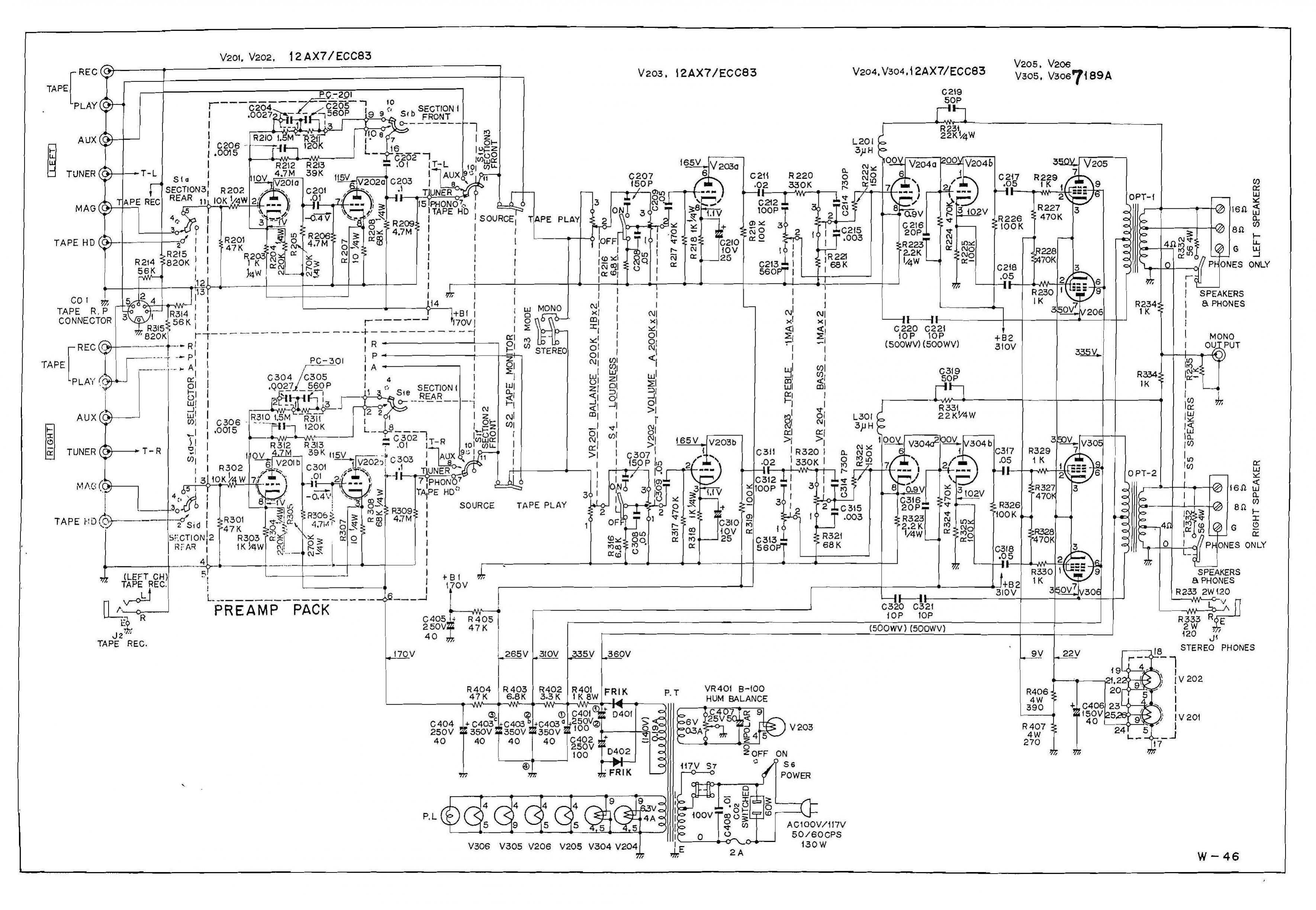

Trio 1966 tube recevier W46K:
50uFx360V+50uFx335V+40uFx310V and resistors 1k, 33k, 6.8k etc.
Trio W-46K Restoration | twiddlingmyknobs

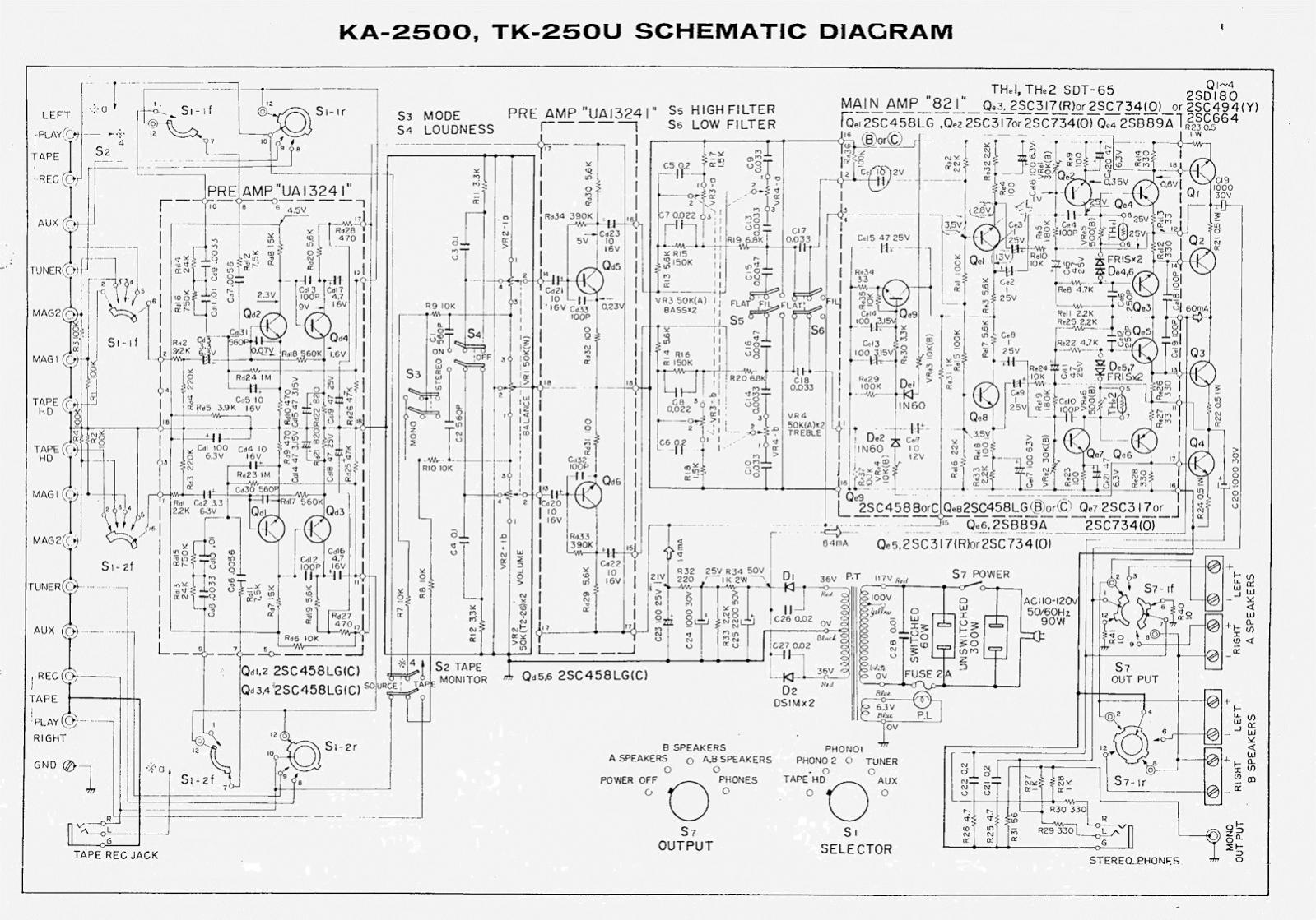

Trio 1973 transistor receiver:
2200uFx50V + 1000uFx25 V and one resistor 1k:
Doz' Blog: Trio (Kenwood) KA-2500 amplifier repair & renovations.
