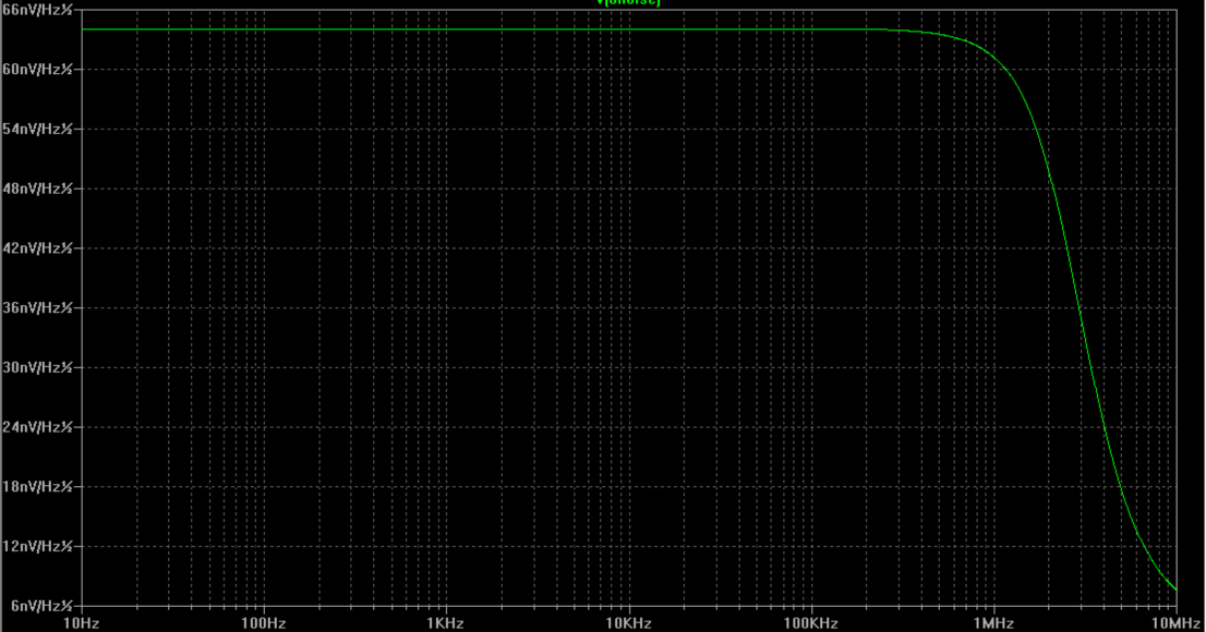

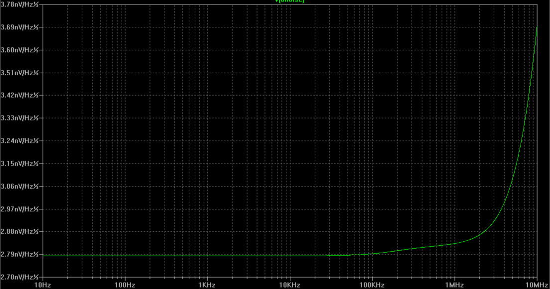

To be clear, SNR versus frequency for the opamp? Like this? One is at gain of 10 and other is configured as a buffer.
I'm assuming a pre->buffer->opamp->opamp->buffer->amp config.

So you are cascading two Sallen-Key filter sections with buffer ahead and after? Are you defining a large passband in this fashion, thus a low-frequency highpass followed by a high-frequency lowpass?
Circuits using opamps, and in particular filters, have "noise gain", and Sallen-Key topologies are no exception. Actually some S-K ones are quite low noise gain compared to other topologies. In any event, lower impedances (smaller resistances, bigger capacitances) to realize a given transfer function will always be lower noise (lower thermal noise due to the resistors), but will require more current to drive, both from a given driving source and from the opamp itself.
The noise gain, meaning the frequency-dependent multiplier of the opamp voltage noise (the opamp input current noise effects are treated separately), is dependent on, but not identical to, the realized overall filter transfer function. Higher Q will generally entail higher noise gain. For most audio work with lowpass and highpass filters, the Q will be modest (little or no peaking in the frequency domain transitioning into the stopband).
that, or two LPF or two HPF, etc.
Thanks for the explanation. It would still be nice to have a rule of thumb. It sounds like the answer is to construct a model for the entire filter and evaluate it en masse. Perhaps, stepping through the model over multiple xover frequencies. Drop in another opamp model and repeat, rinse, etc.

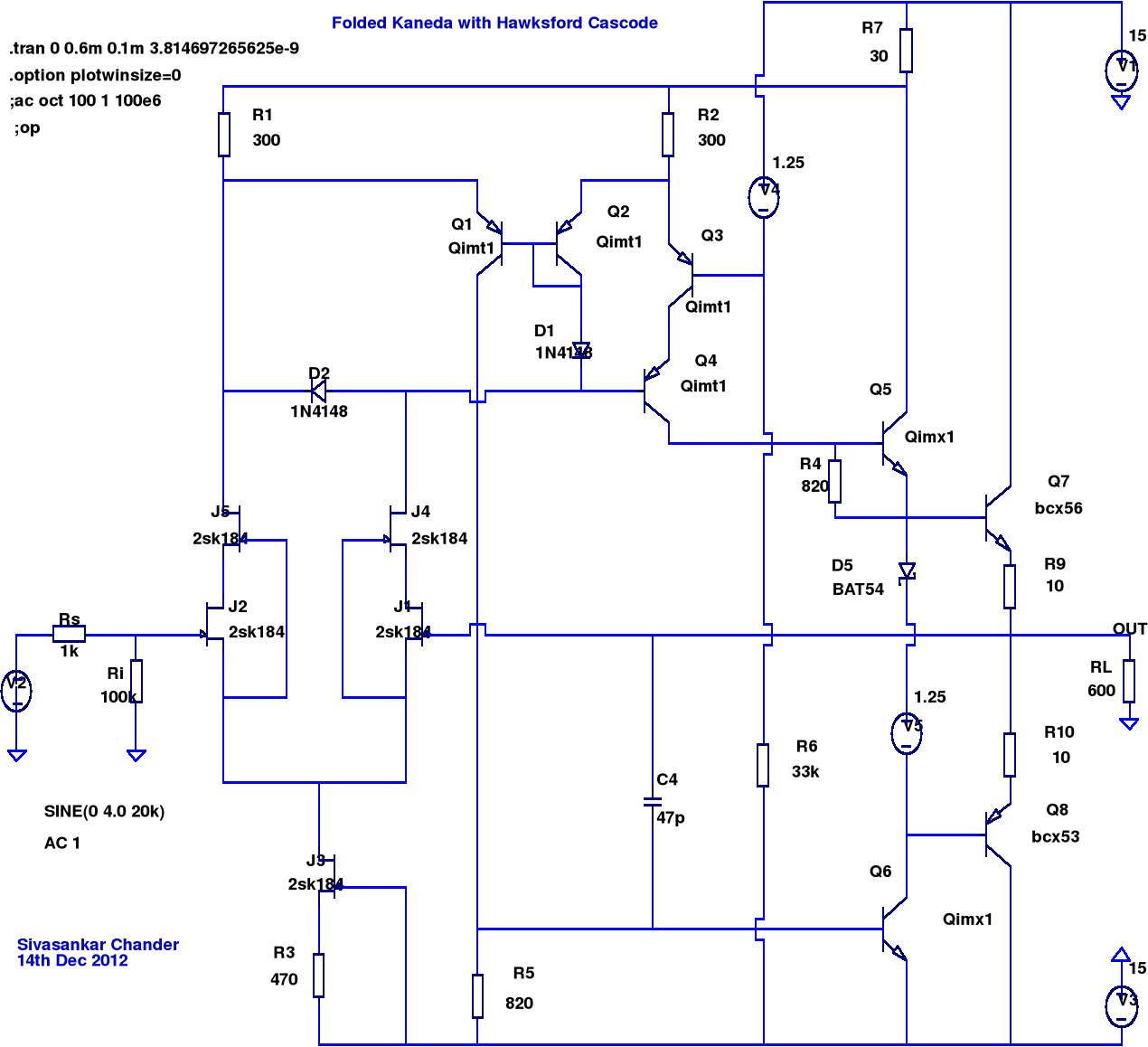

I added a few circuit elaborations to the basic folded Kaneda, and the performance improvement is dramatic.
1. Added a Class-AB push-pull buffer to reduce loading on the totem-pole VAS.
2. Added a Hawksford Cascode to the PNP driving the upper NPN of the totem pole - this is the game changer for the VAS.
3. Cascoded the LTP JFETs - contributes a few dB in THD20 reduction.
It's now at 13 actives, but all the additional devices are worth it. Compensation tweaks, clipping/overload, stability, etc. haven't been investigated.
Here's the basic circuit, which I'll call the Folded Kaneda-Hawksford.

... Can you post your transistor models too.
The JFET model is the same as the 2sk117/184/209/2145 posted earlier - you can use the 2sk170 model in a pinch.
Here are the BJT models, downloaded from Infineon and Rohm respectively.
Edit: The output stage models are not critical - I cross-checked with NXP BCX56 and BCX51 models: Icq is within 15 per cent, and THD20 is within a few dB of the Infineon models attached.
