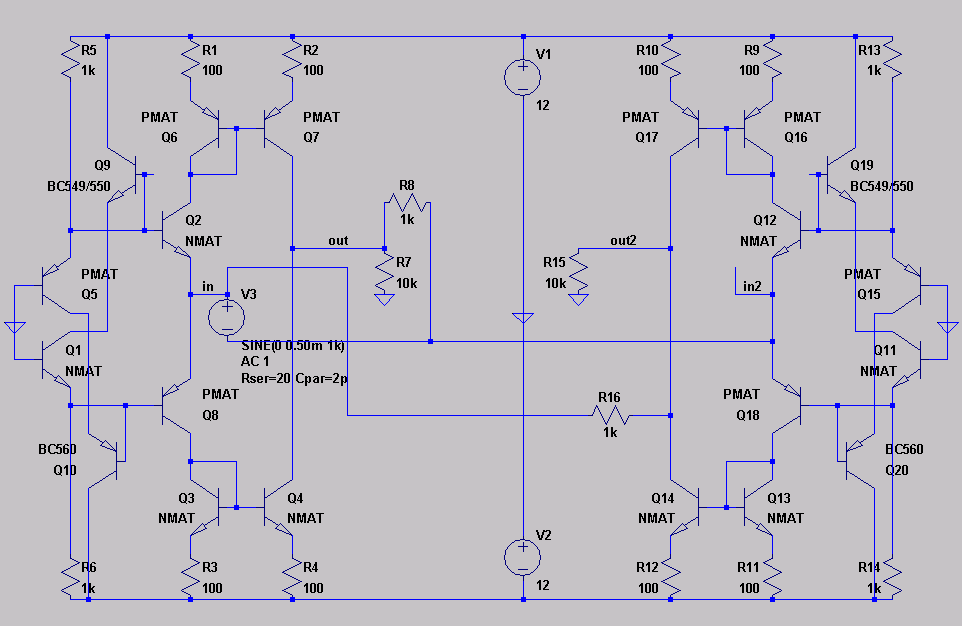

If this circuit would work, which is a spin off of a topology of Tietze/Schenk, we had a balanced-SuSy-current-feedback-input stage for MC (phono) with THD to die for.
But I fear the DC-biasing won't be close to the simulation nor stiff enough in reality. Bandwith (-3dB point) sims 1.2MHz, gain is 41 dB
In sim, there is virtually *no* current or voltage through/over V3 (the MC-cart).
Rüdiger
Rüdiger
