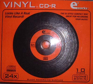

i too like black cd's i find that cd players that cant read cd-r's will read the black cd's..

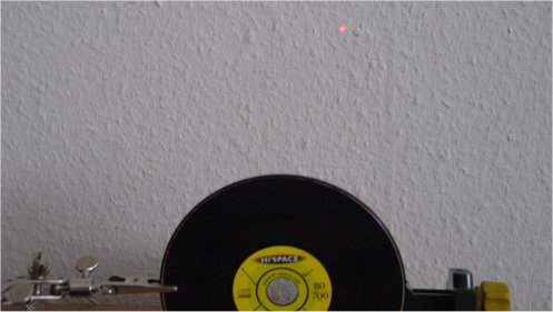

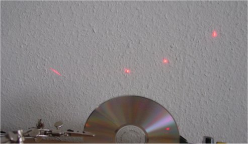

Hi
Transparent discs modulate the reflection (i.e. induce jitter) by means of text and labels and stuff.
Black CDs are far less transparant.
that is all, except for the general jitter / writing quality issue, but that is color independant........
