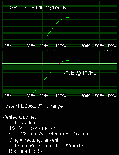

Konnichiwa,
Well, an enclosure like this will not solve many of the problems (there will remain a 10db tilt upwards at high frequencies) but it will now introduce at least one major one.
Namely a severe LF power handling problem, making the use of a Highpass at around 80...100Hz mandatory. The highpass needs to be probably at least 2nd order, so now we have the 6th order Highpass function around 80Hz. That is most definitly NOT GOOD.
If you wher eto use a small sealed enclosure and a 2nd order Highpass with some boost at the corner frequency you would have a much better result while keeping the rolloff order at a sensible point.
I would still think that using a larger sealed enclosure (say 40 Liter floor standing column) together with Nelsons suggested principle of a high output impedance amplifier makes a lot more sense, as it will actually turn the system into a true fullrange system with pretty good overall response.
While obviously reviled among the Pass Labs Boards contributors, the kind of Chipamp often known as "Gainclone" can be used to make a transconductance amplifier (current output) on a shoestring and there it is also possible to incorporate the EQ networks into the feedback loop, making the whole excercise quite inexensive to try.
Sayonara

Thanks, but I would rather prefer a sealed than ported...
In fact, as neither of them are suitable for FE 206E, and a horn can be quite difficult to build, I am wondering if the transmission line will work? Some folks have built Martin J. King's "Virtual Fostex FE-206E and FE-207E ML TL Design" and they seem to be satisfied with the result...
I did not mention it in the first post: I am also using two DIY sealed subwoofers, each using 12" driver, whith the active, equalized crossover at about 65 Hz. In fact, it is controlled by Rod Eliott's "Subwoofer Processor-P.48". So it seems that in this arrangement Fostex can work in a big sealed enclosure...

Vix said:Thanks, but I would rather prefer a sealed than ported...
