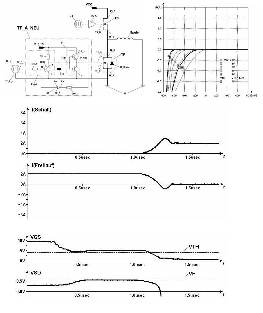

Hello,
I am new here in this forum and I am very interested in this topic.
An interesting alternative to the shottky diode is a
- voltage control
- of the output voltage of the freewheel FET
- during the transition between the
- freewheel phase and the
- switching phase
If you
- control the output voltage to a value, e.g. 0.6V
- the intrinsic diode of the freewheel FET
- will not become conductive.
I attached some waveforms. If anybody is interested, I will give much more explanations.
Greetings,
Matthias
P.S.: I was posting something before. Please consider this as a draft. I was pushing the Submit Reply Bottom unintentionally.

MIAS' method is interesting. I just wanted to know what happens with this technique if the current in the inductor is 10's of ampere headed to base of the totempole's predriver (only mA here). Will it ruin the predriver or stage before predriver?
Hello lumanauw,
Very interesting. Could you tell more?
I made this circuit in my vacancy. The really funny thing is: It looks risky, but it is not. The thing is a
- MOSFET
- can get conductive in reverse mode
- below its threshold voltage.
This why you can control a MOSFET with a gate voltage very little above the threshold voltage. And this is why during the whole transistion a bridge short circuit is safely prevented. As one can see in the graph - when the MOSFET gets into forward mode the gate-source voltage is below the treshold voltage.🙂
In your right drawing, there is additional C at the base of totem pole and R+dioda from base of totempole driver to drain of mosfet.
This capacitor has the effect to eleminate the influence of the miller capacitor. In reverse mode this capacitor can lead to a ringing tendency. The gain of the control circuit is high, can be decreased with a resistor between the emitter of the npn transistor in the totempole circuit and GND. But this has then other problems - I tried it.
I did not try so many AMPs. Then also the stray inductances may play a role. Nevertheless, the MOS-Drive circuit is safe from being damaged. The Push Pull Circuit has to be low ohmic in any case, otherwise you will get some funny steering of the Freewheel FET in linear mode also, when you use a conventional MOS Drive.
Greetings,
Matthias

Hi, MIAS,
I have a dumb question. In your drawing, you don't use external dioda (parrarel to the body dioda).
If the body dioda is already disabled with your method. The upper mosfet is already off, but the lower mosfet is not on yet, the left side of the inductor will instantly change polarity 180deg, where will this energi inside the inductor go to, since the body dioda is already disabled, but there is no external dioda (parrarel with body dioda's position)?

Hello lumanauw,
One cannot disable the intrinsic diode. All you can try is to get this part of the freewheel FET not conductive. In the transistion phase
- when the upper FET is switching off
- and the regulator circuit is not reacting so fast,
the only thing what is happening is that the diode could become conductive, before the freewheel FET is switched
- either hardly
- or the regulation is reacting.

But otherwise, how do you control low side FET when current polarity is normal (from drain to source)?
In the circuit diagram I sketched the MOS-driver is pretty lowohmic. It must only be active when the Low Side Transistor cannot generate any switching slopes, etc.. In case of the low side transistor gets in the role of the switching FET, then you have to steer on the FET more high-ohmic, i.e. with a defined gate resistor.
Nevertheless, I strongly recommend in any case to do this, also in case of I do not want any control. In case of you use the FET as Freewheel FET always take care you have a low ohmic - I mean a very low ohmic - current sink. Otherwise you will charge up your gate and steer the Freewheel FET in the linear region during the transistion phase, which makes neverending troubles.
Of course, in the phases where the FET gets forward conductive, you cannot switch OFF the gate without preresistor.
Greetings,
Matthias
I don't understand this! High/low ohmic? How could this solve the problem? MOSFET needs completely different gate-control depending on the direction of drain-current, because at positive drain-current your control-loop turns to positive feedback, and switches off. In an amplifier this happens in every cycle at idle (and at low signal levels), but you mustn't allow switching off just because the current changes its polarity, FET have to stay ON till the next half-cycle!
Hello Pafi,
I might be wrong, because I did not try it up to now. But let me give a chance to explain.
My circuit is only active, when this signal at the entry of the totem pole stage is high because then - and only then - a current can flow through this small signal diode that closes the control lope.
When you want to steer ON the FET in forward mode, you have to put the entry signal of the totem pole drive to zero, and then this small signal diode is no longer conductive and will have no influence.
This means the circuit I propose is only active when you try to switch OFF the FET. And even then, it is only active in reverse mode. When you have a positive drain source voltage the current through the small signal diode will become zero because of the resistor in series. All the current which is coming from the input signal and the resistor between the input signal and the base of the bipolar transistor at the entry of the totem pole stage is flowing in the base of this transistor.
There is only a problem with the switching slopes. You might get a too fast di/dt with this gate drive circuit when you are operating the transistor in forward mode. Neverheless, in forward mode the control loop cannot be active. It will only operate in reverse mode.
Greetings,
Matthias
P.S.: My circuit is just for substituting the shottky diode in parallel to the FET, means for realtivly low voltages. When you have a real high voltage operation you can oly get rid of the storage charge effect by
