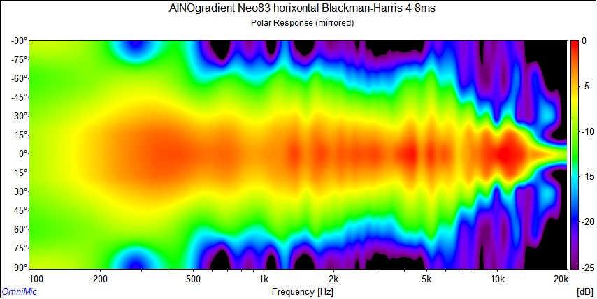

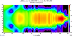

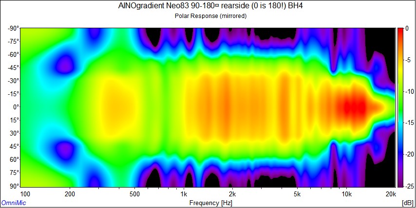

More dipole-like at the bottom, it blends nice with omnipolar sealed subs in order to form nice cardioid in midbass too.
This I did with my old NaO Mini design: sealed sub with dipole mids and transition through x-o was dipole to cardioid to monopole. Also with a little speaker I called the Bird Cage.
"The design of the NaO Mini employing dual woofers (one woofer for each channel) uses a novel approach to accomplish this result for low frequency reproduction. Referring again to the Technical Studies area, and specifically to the technical article on Crossovers between different sources, it is apparent that when a monopole source (Mini woofer) is crossed over to a dipole source (Mini panel) using a 4th order acoustic crossover the polar response varies continuously from a dipole above the crossover, to a cardioid through the crossover region and then finally to a monopole response well below the crossover point. Since the crossover between the dipole panel and monopole woofer is centered in the sparsely modal region such a combination should result in a system which tends to minimize low frequency room interaction effects and sensitivity to placement."
From: NaO Mini Design Objectives
^That approach was also used in Gradient1.n series speakers in 1980's. I did it with minidsp utilizing ~160Hz/LR2 acoustic transition, because it gives wider range of cardioid and smoother transition zones - sounded better to my and friends' ears!
front and rearside horizontal polar measurements, indoors.
