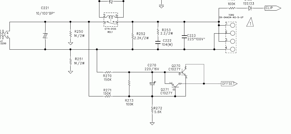

Directed 1500D
You need to find the equivalent of Q270 and Q271. Finding the ones with their collectors connected together and their base and emitters connected together should make it easier. When you find them, remove them to see if they amp will power up. If it does, check each one carefully.
