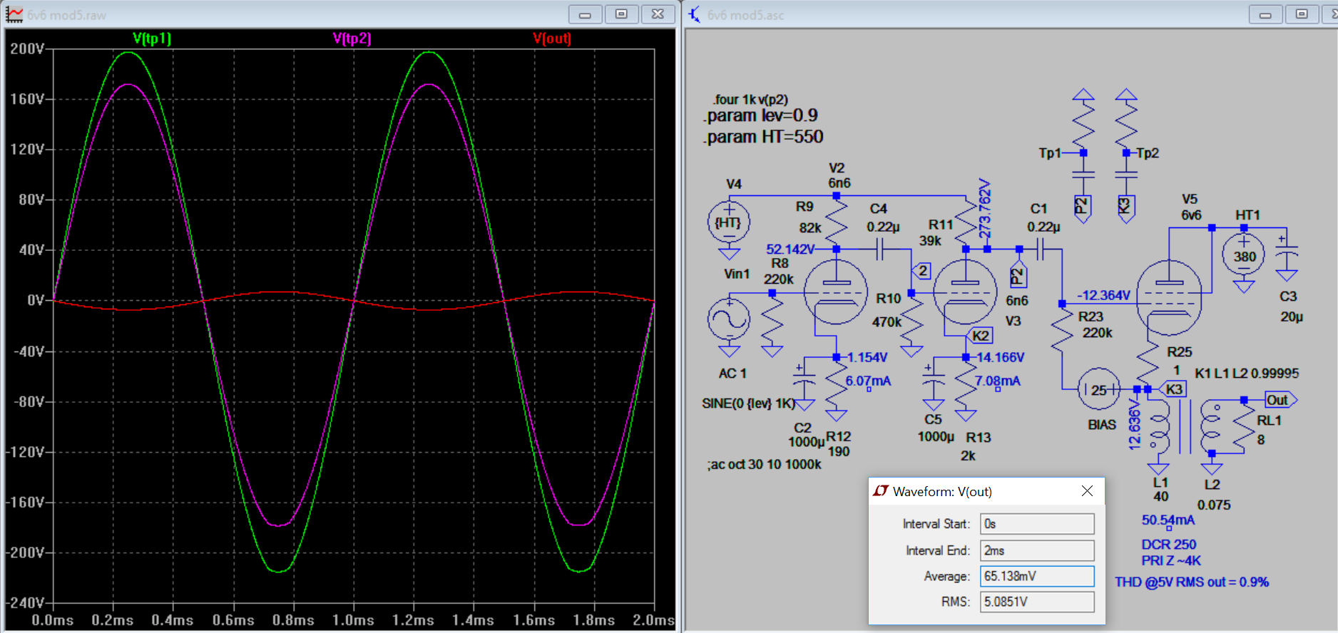

I constructed a model of the amplifier circuit to see how it behaved with models of the tubes.
audiowize, that corresponds to 4V peak at the speaker. I didn't get that when running the simulation, I clipped before that.
In addition, I agree. 164Vrms is 239V peak. Divided by 4V peak is a turns ratio of almost 60:1. a 6K to 8 transformer has a turns ratio of Sqrt6000/8 = 27.4:1
Something is not adding up.

Just over 3 watts using 6n6 driver I sim before. It'll need about 125V RMS on the primary of a 4k OT to give 5V RMS out on 8 ohms load. So confirmed it's the driver needs rework (how?) since it is unable to drive the output stage to full output or only 1/4 watt out as per original schematic.

4.5W at the speaker means 164V RMS at the primary of the output transformer. There is something not adding up here

I read through this design not too long ago and came up with the same questions that audiowize and TheGimp have.
With a 6k primary impedance and 4.5W output we need a peak-to-peak voltage swing on the primary of:
sqrt(6,000 x 8 x 4.5) = 460V
The 6SJ7 is resistor loaded (100k) with a B+ of 250V. It can swing right down to 0V on the anode, so call it 250V peak-to-peak (though it looks like the bias point wouldn't allow it).
The output looks to me like a transformer coupled/loaded cathode follower. So it will provide unity gain. 250V ptp into a 6k primary nets just over a watt.
Am I missing something?
I don't think so.
Also, with a 6V6 (triode-connected) with 250V across it at idle, I think it is optimistic to think you can swing more than 300Vpk-pk into the transformer primary with a theoretically perfect and limitless driver. That would give you ~1.8W max undistorted.
I'm not even sure it is possible to get 4.5W out at these conditions even if the output is a square wave. I think the author fudged the numbers here or made a mistake.
