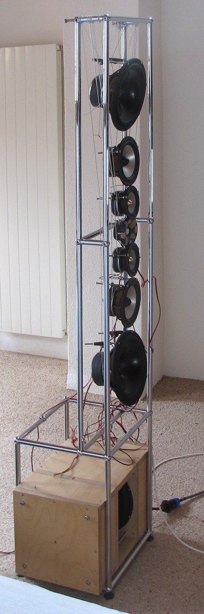

So? This is my actual concept project: A 5- to 6- way dipole. Mutations occur nearly every week-end.
When finished, which I hope will never be the case, there will be two units per channel: A woofer two-way unit 60-170/170-285, and a mid-treble three-way unit 285-710/710-2200/2200. Plus maybe a subwoofer elswhere in the room, where it's best suited. Specs and distances from driver to driver are chosen in order to perform the transitions with lobing <1dB (except for the highmid-tweeter xover), and for a target SPL of 110dB@f_crossover@Xmax/2. Not @ Xmax, but Xmax/2, in order to keep distortion low, even at a theoretical volume-displacement-limited SPL of 116dB for the whole system.

Can you tell us what's going on with the segmented baffle on what looks to be a ripole?.
By the looks of it, it is the stand on the 3-way that is supposed to fit right into the baffle of the sub
Right! This baffle particularity is a meaningless leftover from a former iterative step ...
This version was a failure due to gross vertical lobing of the low midrange drivers at the transition to the high midrange. So I ommitted one or the lowmid drivers to minimize vertical dimensions.
In order to
1. maintain the target spl specs ...
2. improve lobing between the W-Bass and the low-mid driver ...
I added a 5th way, some kind of filler upper-bass 12" driver.
So the (old) baffle in the new interative step still has 7"-spaced slots, whereas the new stand of the 12" has it's tubes spaced by 10". There soon will be a more consequent baffle for the W-Bass in order to improve it's efficiency. This is now possible due to the lower xover between w-bass and upper-bass (170Hz)

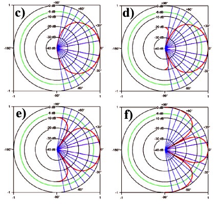

Now for something completely different ... Having left Horbach-Keele-Designs (HK) aside some time ago because of the practical limitations inherent within the top frequency range (size of drivers, spl), I recently took another approach with Dipole-HK in order to minimize early reflections from room boundaries. Within this iteration, I try to deal with the floor (and ceiling) reflection.
HK theoretically provides constant directivity within the vertical plane. By choosing the appropriate parameters for the filters, it should be possible to design an array such as a lobing null is directly headed towards the point(s) of reflection between the center of the speaker and the hearing position, located at the floor (and/or the ceiling). With such an array, consequently no sound will be fed into this reflections at all.
Figure e) e.g. shows a configuration, where the null occurs at approx. 55°. Designing the system for a real-world situation with the central tweeter at 128cm, a listening distance of 215cm and an ear height at 128cm, the needed angle of the null would be at approx. 50°. This transform into D/Lambda=0.65 and a beamwidth (BW) of 62° for the design of the HK-parameters.
This system should be considered as a very early prototype, and so are it's filters. It is only a partial HK-System, because of the three pairs of drivers provide constant directivity only in the range of approx. 200Hz...1100Hz. Therefore, the first SPL-cancellation due to the ground reflection, which in this setup will occur at 144Hz, cannot be avoided. To circumvent this dip in a final version, the single woofer could cross over at some 150Hz ... 170Hz in order to provide some spl of -6db ... -4dB pressure at 144Hz.

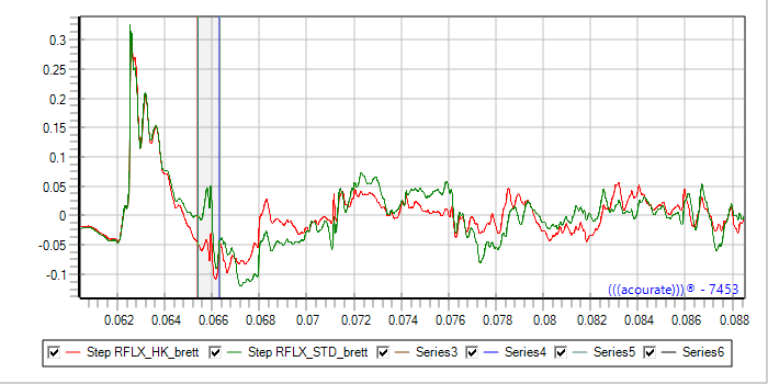

Now, does this theoretical approach work? For a first measurement, accordingly to HK the full array was fed (red). For a second measurement, the upper half of the array was disconnected. So only the bottom half of the array was fed, making up for some kind of a "standard" setup with the bass drivers low above ground, up to the tweeter at ear height (green).
As mentionned before, red trace is HK, green trace is the standard-system. The marked section of the pulse response shows both ground reflections artefacts (the spike at 0.0682 is an unavoidable room artefact which has nothing to do with the ground/ceiling).
HK seems to work as expected ... That's good news for the search of minimizing early room artefacts (and so are dipoles, anyway).
