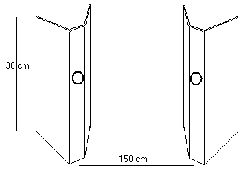

There are so many questions in this thread and every answer is enlightening. So I will try to give in my share:
Dimensions of Baffle:
As I learned in another forum, width of the baffle is not the crucial criterion. Determinant is the time delay between the front wave and the back wave of the dipole speaker at the hearing position. So if you have large baffle wings like in an H-frame, their length will count (almost) double (because the backwave has to travel way back round the wing edge and way forward to the plane of the speaker).
I have dimensioned my open baffles following these thoughts. They have very small loudspeaker baffles and tilted back wings (40 and 50 cm deep). They are tilted in 90° and 45° and I don´t hear any „box“ effects until the angle between the wings becomes less than 30°.
These baffles are optically much less „intruding“ than „fat“ baffles and will certainly reach down to the 90 Hz Fs of my little 3“-woofers.

Variac and Rudolf,
Thanks for the inputs. In particular, Rudolf's baffles were a very interesting counterpoint to the "large, flat, and ungainly" I was thinking of so far. I may not need your larger baffles, because I'm toying with a higher XO frequency, maybe something like 300Hz. Is there any reason to believe 300Hz will be too high?
I'm actually toying with the idea of building some prototypes for a friend, using really inexpensive drivers. (They're prototypes, remember?) The local Philips India brand sells some drivers, including an 8" dual-cone "full-range", for about USD 5.00 each. I'll use this for the mids, from 300Hz to maybe 5KHz. Then bring in a dome tweeter using a single cap. The 8" and the dome tweeter will be on an OB, dimensions and shape to be experimented with.
Below 300Hz, I'll try building either a two-driver H-frame like Steve's or a one-driver box (sealed, perhaps). This too depends on money. And Dave's posting about being able to keep the woofer boxes further back seem like a good idea. If the woofer box is half-XO-wavelength back, does this mean I'll have to have the woofer 180-deg out of phase with the mid? I guess I will, right? And is there a relationship between the lowest frequency my OB panel handles and the minimum distance from the rear wall?
The 300Hz XO will be active. Inexpensive LM3875 chip amps will be used for power. I'll use the Jordans once I learn from these experiments.
Why do people who build twin-driver H-frame woofers keep the woofers vertical? Won't the boxes be a bit less vibration-prone if kept on their sides? Yet another of my newbie questions...
I'll let you know when we begin work. For now, I think any inputs about any of this are desperately sought, with a newbie-style open-mouthed eagerness.

getting back to dipoles....
starting with a orion what if we rotate the bass part 90 deg and keep the Mid-hf part where it is. that is what if the bass if firing at 90 deg to the mid hf?
also do the "bass boxes" of teh orion have to be staggered? can not the drivers be stagged instead?
consider the bob 3 on steve's site. how deep is the bass box?
steve can you help here? my object is to build a dipole that is very WAF friendly. hence i am looking at side mounted bass drivers that will operate below 100Hz. coupled to either an open back mid (with side walls to lower the F3 of the mid) or a push push TL for the mid.
the drivers i am looking at are:
2 x 12" for the bass in a box that is 30"Hx16"D x 12" W
2 x 6" for the mid and a 1" for the HF
