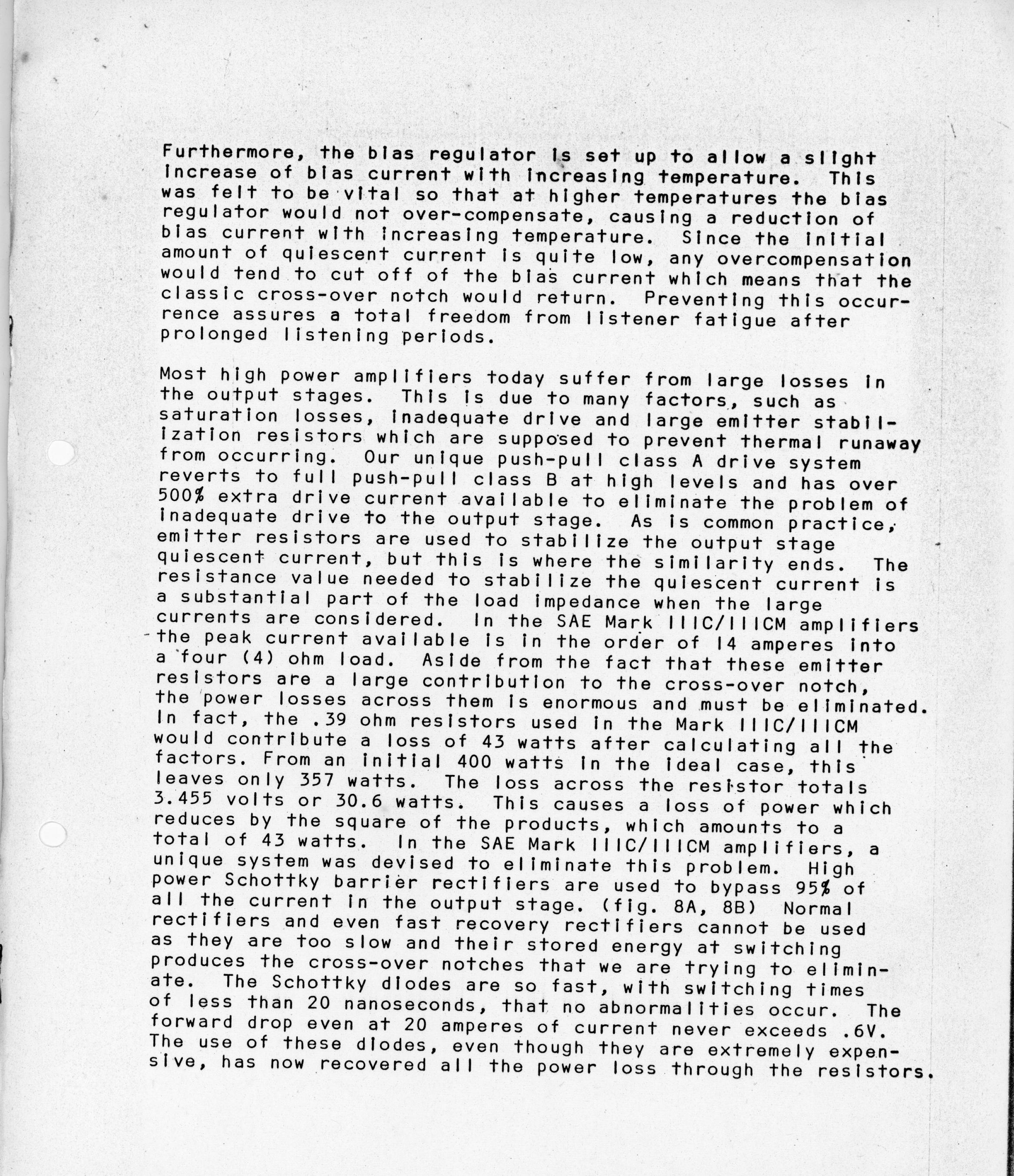

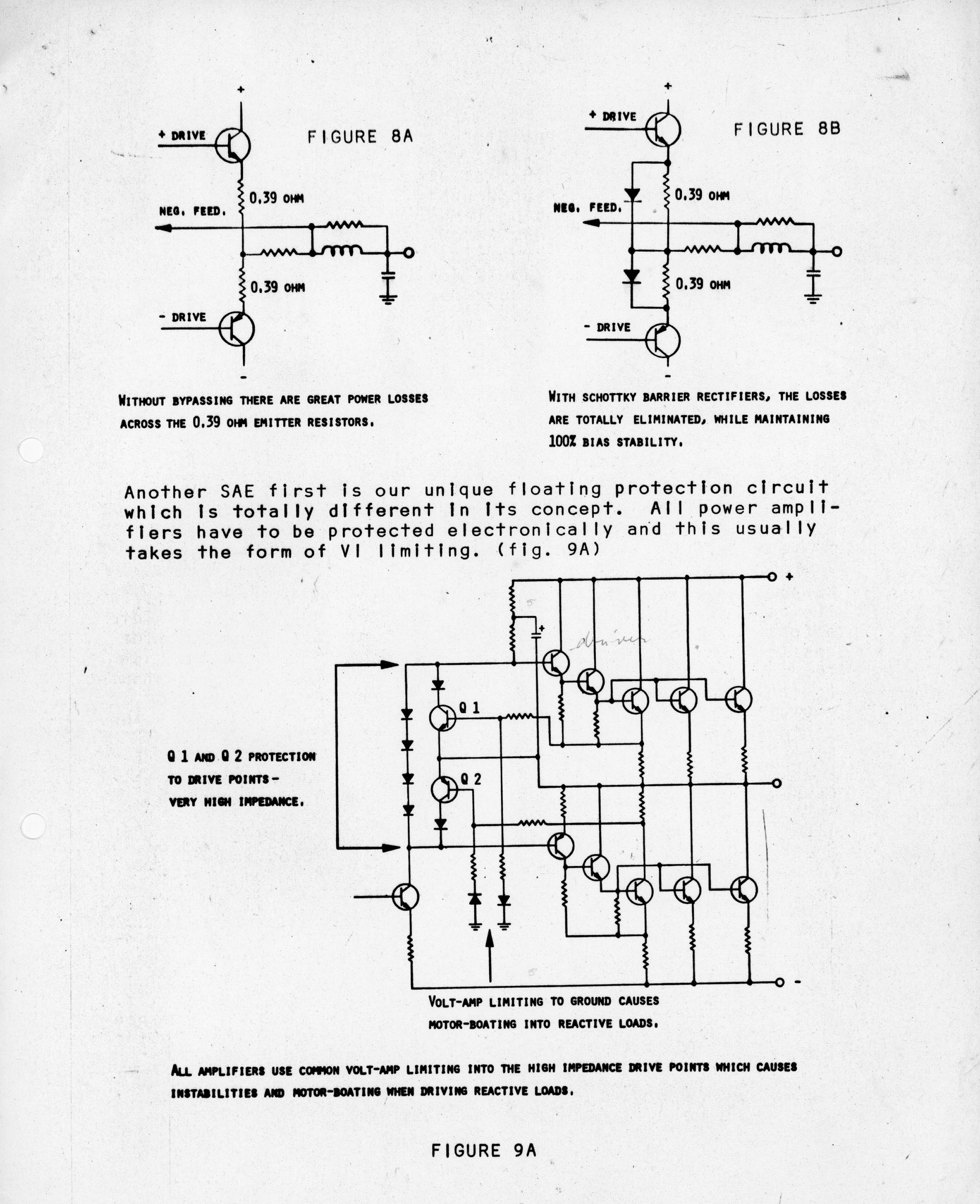

James B. actually did as I posted before. I will scan a page or two...
This is from his white paper modestly called The Ultimate Amplifier.

No contradiction, just two separate ideas. In the Marantz Model 15, the diodes allow one to retain thermal stability without emitter resistors. Apparently JB believes eliminating the emitter resistors improves crossover distortion.JB seems to contradict himself here... if you read the letter from Electronics World he there claims that the diodes are to reduce crossover distortion. No mention of dissipation in emitter resistors..
QSerraTico_Tico. Any possibility of the rest of that white paper?
In the other amp, the diodes across the emitter resistors are just to minimize voltage drop and wasted power at high output currents. As JB said: "completely different purpose".
