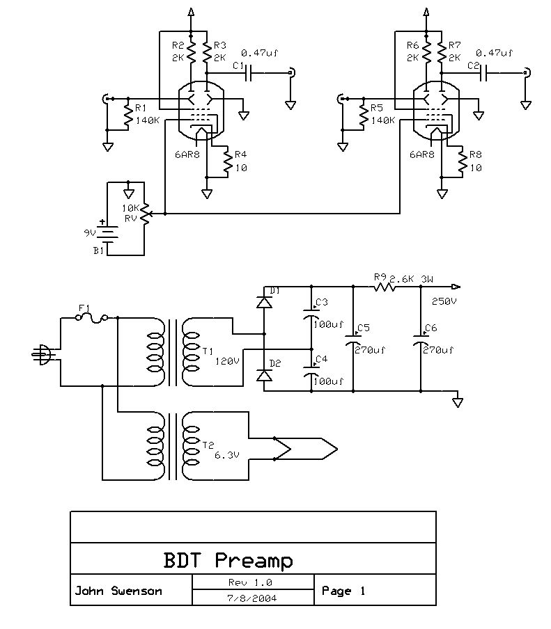

Another Thought
Tubeater / All,
Something I have thought about for this was modiying John Swenson's BDT (6AR8 Beam Triode) preamp - use a digital pot to adjust the negative bias voltage - see attached. Modification of this design would enable a digitally controlled completely tube signal path.
Food for thought, cheers -ALBQ

My doubts are that the AD5290 won't survive the poweron, since at this moment the caps that filter the HV are not charged and the whole HV hits the chip, but I will do some simulations.... I will post when done.
Any ideas of using a small DigiPot in combination with some JFET or MOSFET to do the control work?

By the way: my simulations show that I have some signal level of +- 40V something... I will have to stack 3 of the chips :( but it seems to be possible tough...
