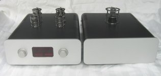

anyone implimented a digital (or other SS) volume control in their tube amplification? I'm thinking it would provide a relatively simple and clean faceplate solution and easily interface with remote control. Especially like the look of the IC based solutions eg Maxim or similar. Comments please.
6 relays, 12 resistors, one uln2001 and a microcontroller. gives 64 steps and I've picked the resistors for 1 db steps. Could easily change the attenuation per step and increase to 128 or even 256 steps if I wanted. Microcontroller is a BasicX24, but could be a pic instead. gonna use buttons for vol up and down, but could easily use a linear variable resistor connected to the microcontroller ADC to adjust volume too.

Do you mean like this? This is an Aikido preamplifier (preamp on the left, power supply on the right) with a Dantimax remote control system.
Scott

thanks guys
very nice solution scott - sorta raises the bar on my expectations! Yeah, I aslo considered relays and resistor networks, but it seems a lot of additional effort and a big opportunity for Mr StuffUp to enter the picture. Maybe at a later date! Thanks for the DS1666 solution - looks like the sort of thing I was after. Cheers all.
