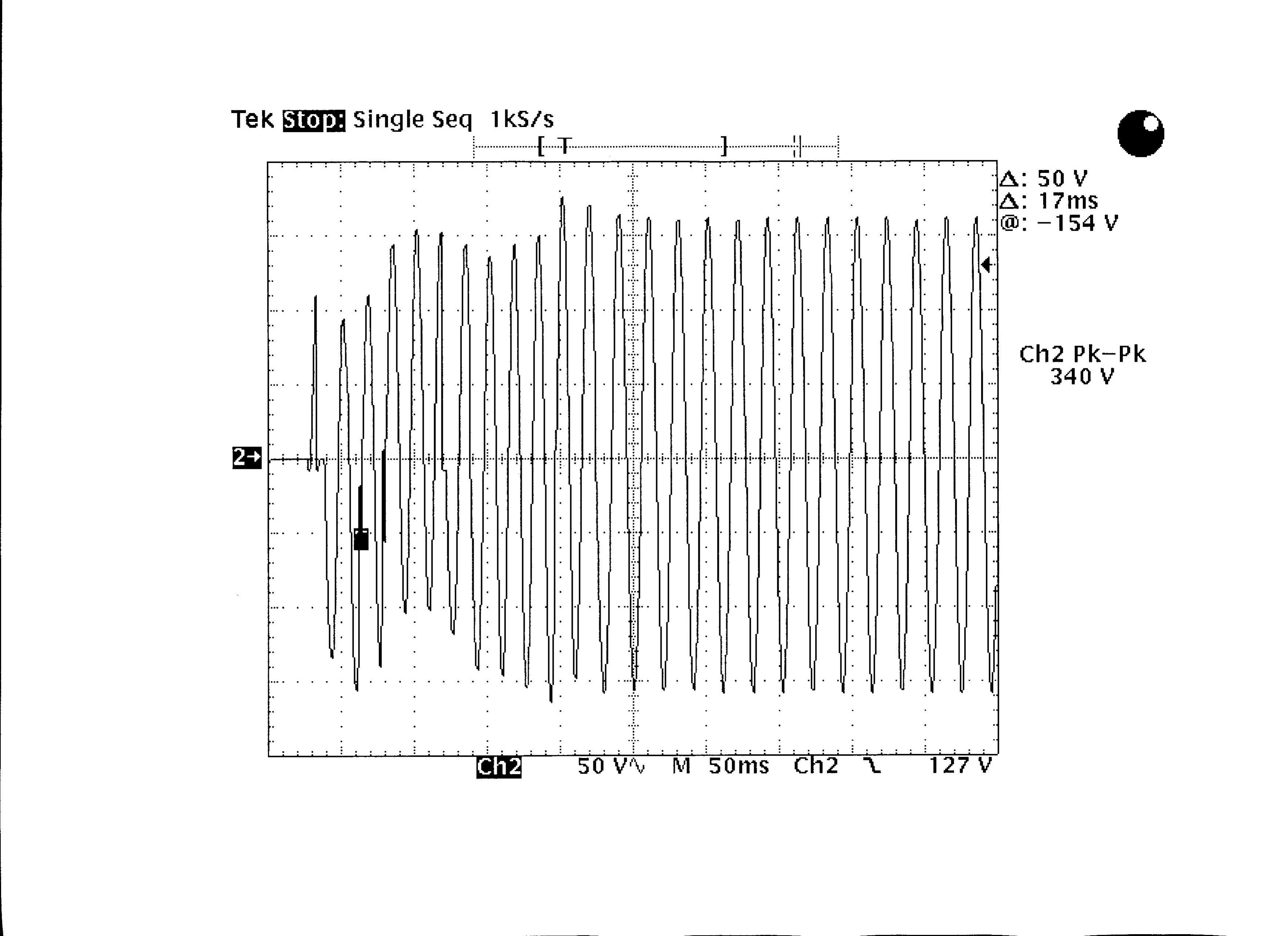

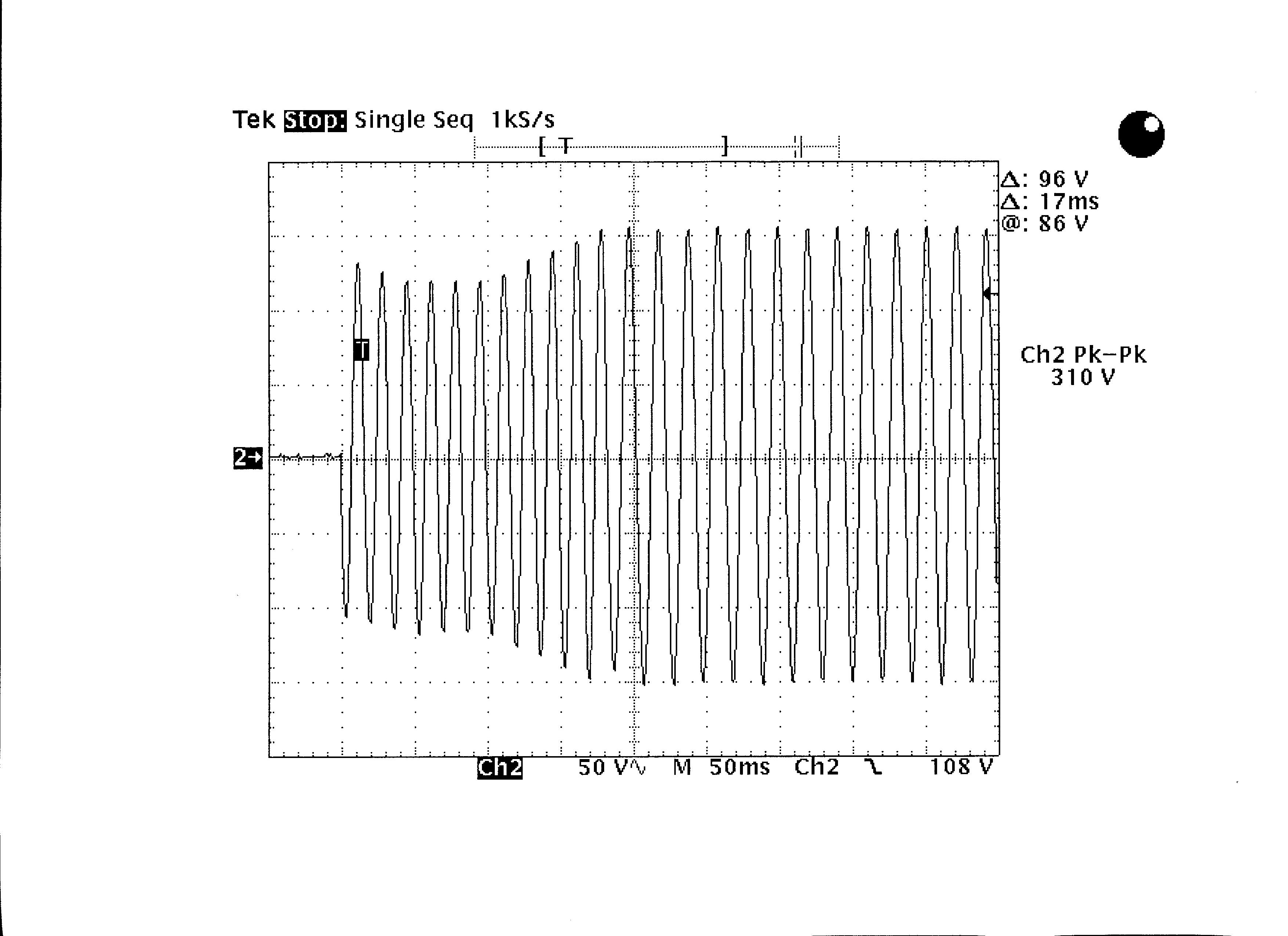

I made an additional change to the start up procedure of the PSU when using a transformer output (as the high power version does). The output amp struggled with the core magnetization when it was started at full power and 50Hz, especially into a light (or no) load. To smooth things out, the frequency starts at 60Hz and minimum level for 100 mS until the the amp has stabilized. The level is then ramped up to full output voltage and the frequency shifted down to 50Hz for the soft start. From there it is ramped up in frequency to 60Hz (33.3 RPM) or 81Hz (45 RPM). This results in a very smooth start regardless of load.
