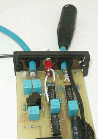

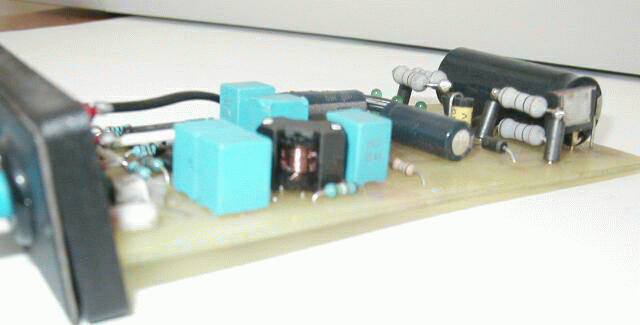

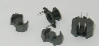

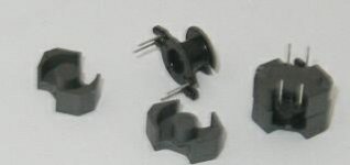

It's rather easy the make a transformer yourself if you know how to do it. It's very important to make it right in order to get good noise isolation.
There was an article in Elektor and in the swedish Allt om Elektronik issue 11, 1999, a few issues back in the english edition.
I recommend you to read the rest of the article. There was also drive circuits.
The transformer from Pulse Engineering is for pure isolation, 1:1, rather good!

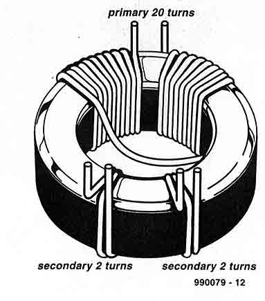

More scientific
The Elektor transformer seems to be rather advanced in it's simplicity. The Pulse Engineering transformer has also advanced winding technique.
