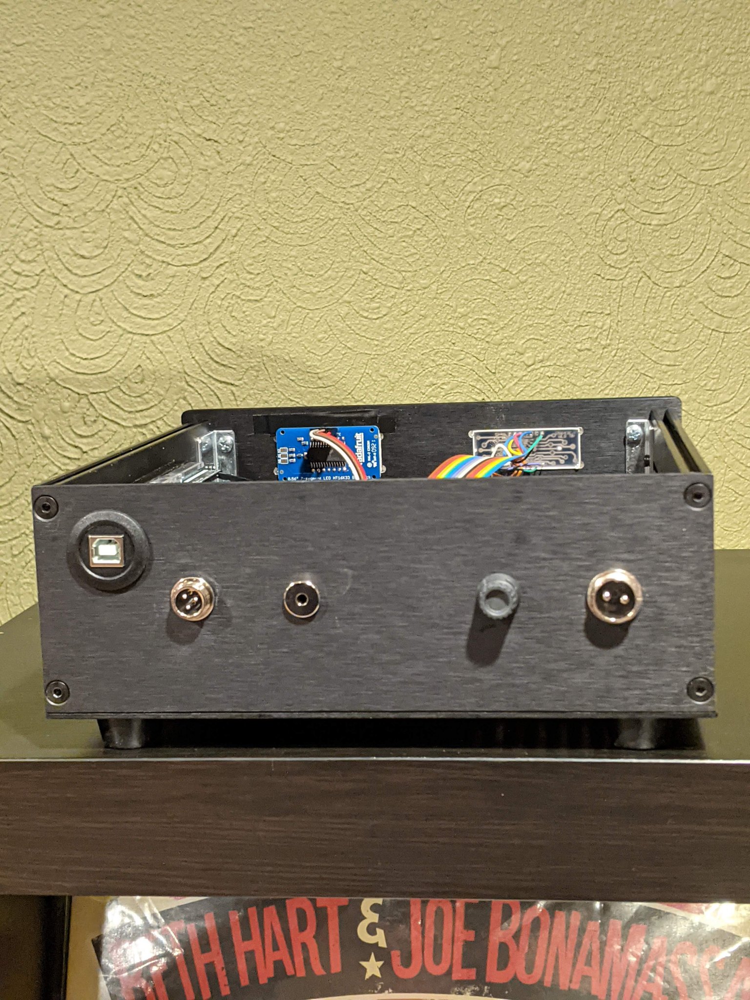

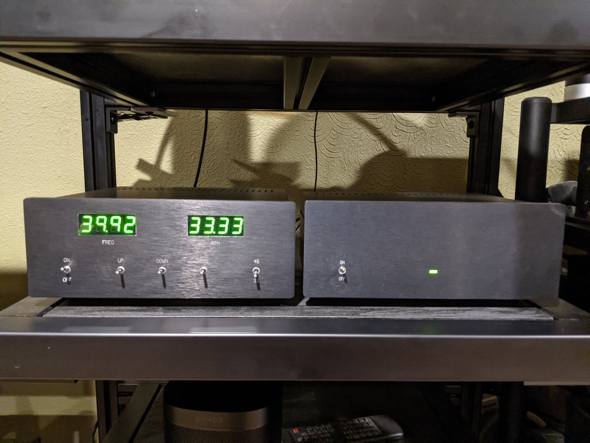

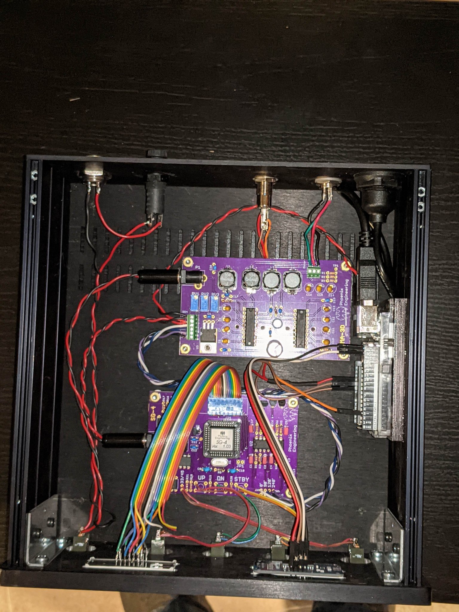

I just finished adding the tach to my SG-4 and MA-3D speed controller this weekend. I mounted the Ardunio to the side of the Galaxy chassis with an adapter plate and machined the faceplate at my work.
I used 2 Adafruit LED displays that are press fit into the faceplate along with smoked Lexan lens.
I ordered the hall sensor PCB from Oshpark and attached it to the plinth with carpet tape, soldering the SMD components was a challenge for these old eyes!
The unit to the right of the speed control is it's power supply.
Thanks to all of you that contributed to this project!

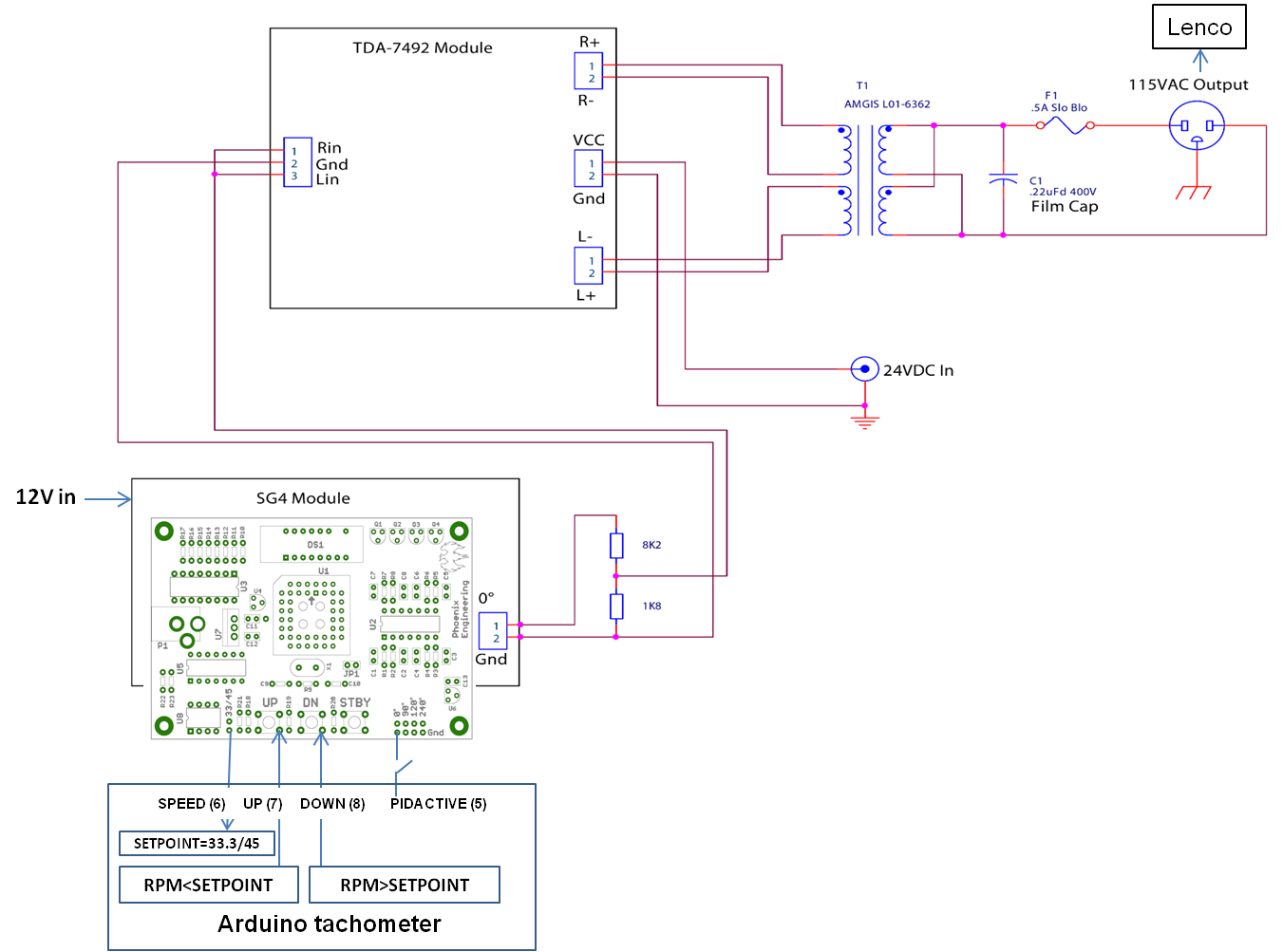

I am a complete noob to all of this but have been able to muddle my through building and using the SG4 with my 50hz Lenco—A big Shout Out to Pyramid for all of his Fine Work.
I have now made an exact copy of Robnik 33'S sketch v7 ( Thank You!!) with the Arduino uno and the same adafruit display but still have problems using the system with my 50 hz Lenco.
  • As Robnik suggested I commented out the 45 rpm set speed
  • The Tach works beautifully
  • When connected exactly as shown in his drawing the sg4 switches back and forth endlessly from 55 to 70 all by itself very rapidly
  • The RPM changes with each move in voltage--reaching 45+ rpm at 70v then slowing down when it shifts back to 55 v.
  • The voltage constantly increases as if the up button is depressed.
    • Pressing the down button while this going on has no effect.
    • The only way to stop it is to pull the up and down wires from the Arduino
    • All of the switches connected to the SG4 work as intended as long as they are not connected to the Arduino
  • I checked every solder joint and switch and can’t find any shorts
  • I inserted 220 OHM resistors between the switches and the Arduino which had no effect.
Any ideas are most welcome

Your description is confusing. If the output voltage is switching rapidly, how does the RPM of the platter have time to change between 45+ and some other speed?
Next you state the voltage constantly increases. FYI, the up/down buttons do not change the voltage, they change the frequency.
If I had to guess, I would say your connections to the Arduino board are not correct; instead of the outputs going to the up/down buttons on the SG4, one of them may be going to the speed select switch instead, causing it to change between 33 and 45 RPM which will also cause the voltage to go to max, then drop down to the reduced voltage level.
It appears the SG4 is working properly per your post, so it has to be the connections between the Arduino and the SG4.
