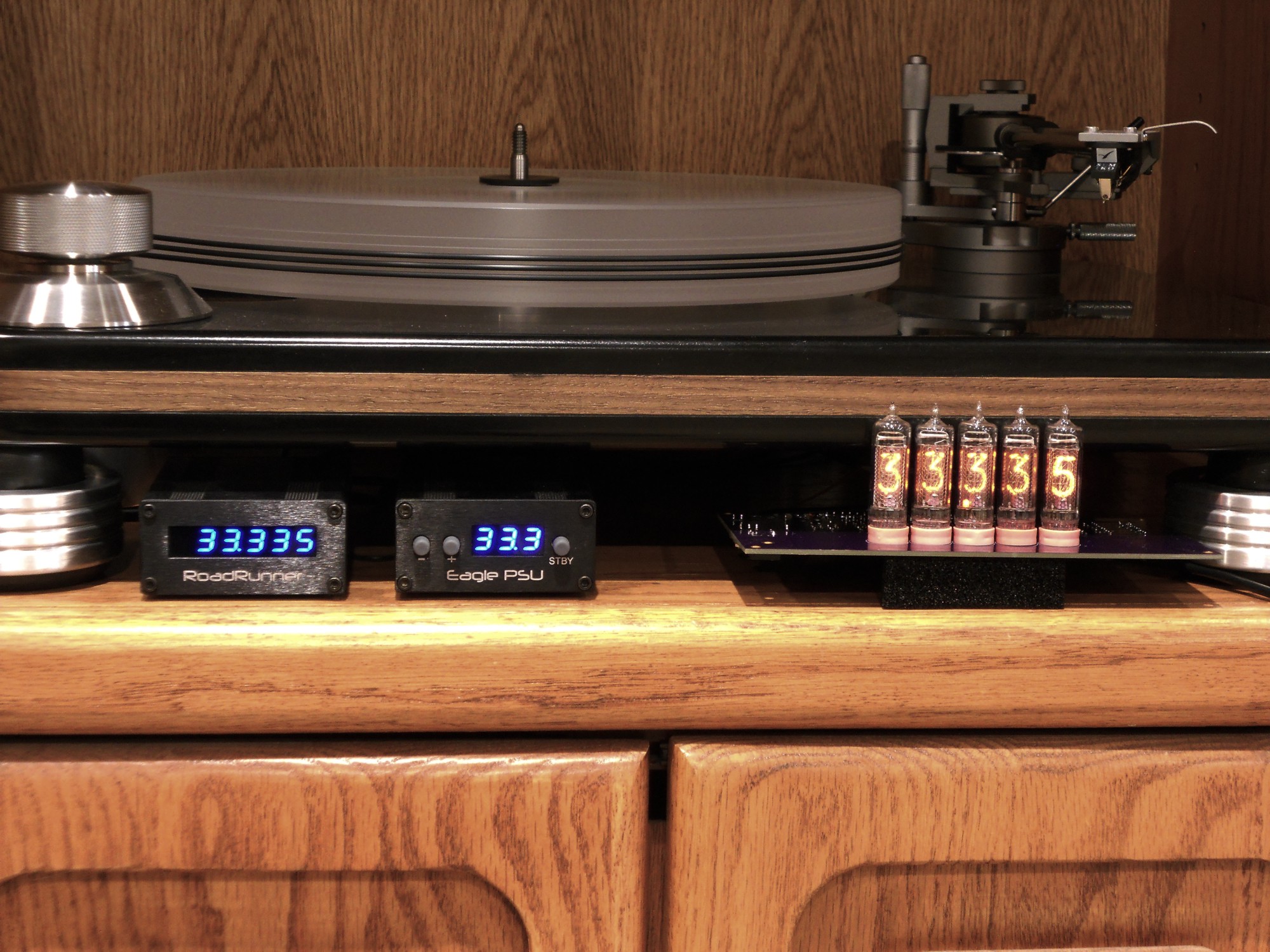

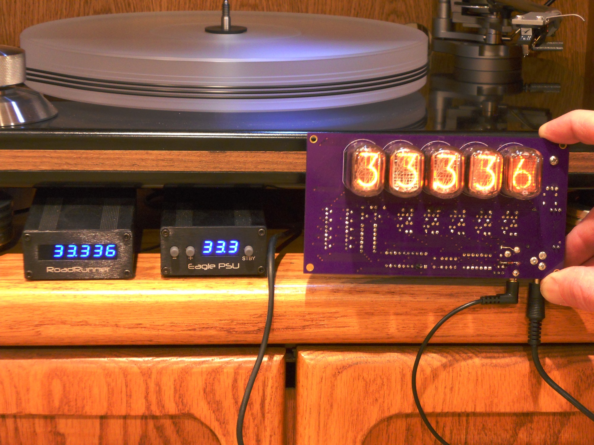

OK, color me bored, but I took a look at doing a Nixie tube tach display. Since this is DIY, I tried to keep the parts count down to a minimum, but there are still a lot of transistors involved (23 N chan FETs and 5 P chan). Good news is it doesn't require any obsolete parts like the 74141, everything is currently available via Digikey.
I did two versions: One uses IN12 tubes the other IN16. The IN16 version is a better looking display and facilitates a vertical display, but is much more difficult to solder the tubes. The IN12 version uses sockets, but the "5" is an upside down 2 and just not as pleasant as the IN16 but better suited for mounting to a front panel.
The Nixie display PCB will accept serial data input at 9600 baud from either a RR tach or the Arduino tach via a 3.5mm connection. Since both outputs are not averaged, the Nixie tube display will be "real time" and not subject to the smoothing action of averaging.
One other thing: It requires an Atmel AT89C2051 pre-programmed with the operating system. I thought about using an Arduino, but they only have one level of interrupt, so I don't know if it would even work and the other problem is I would have to release the source code and a particular mfr has already demonstrated that they are not above pirating a DIY project for commercial use, so I won't be releasing any more source code onto this site.

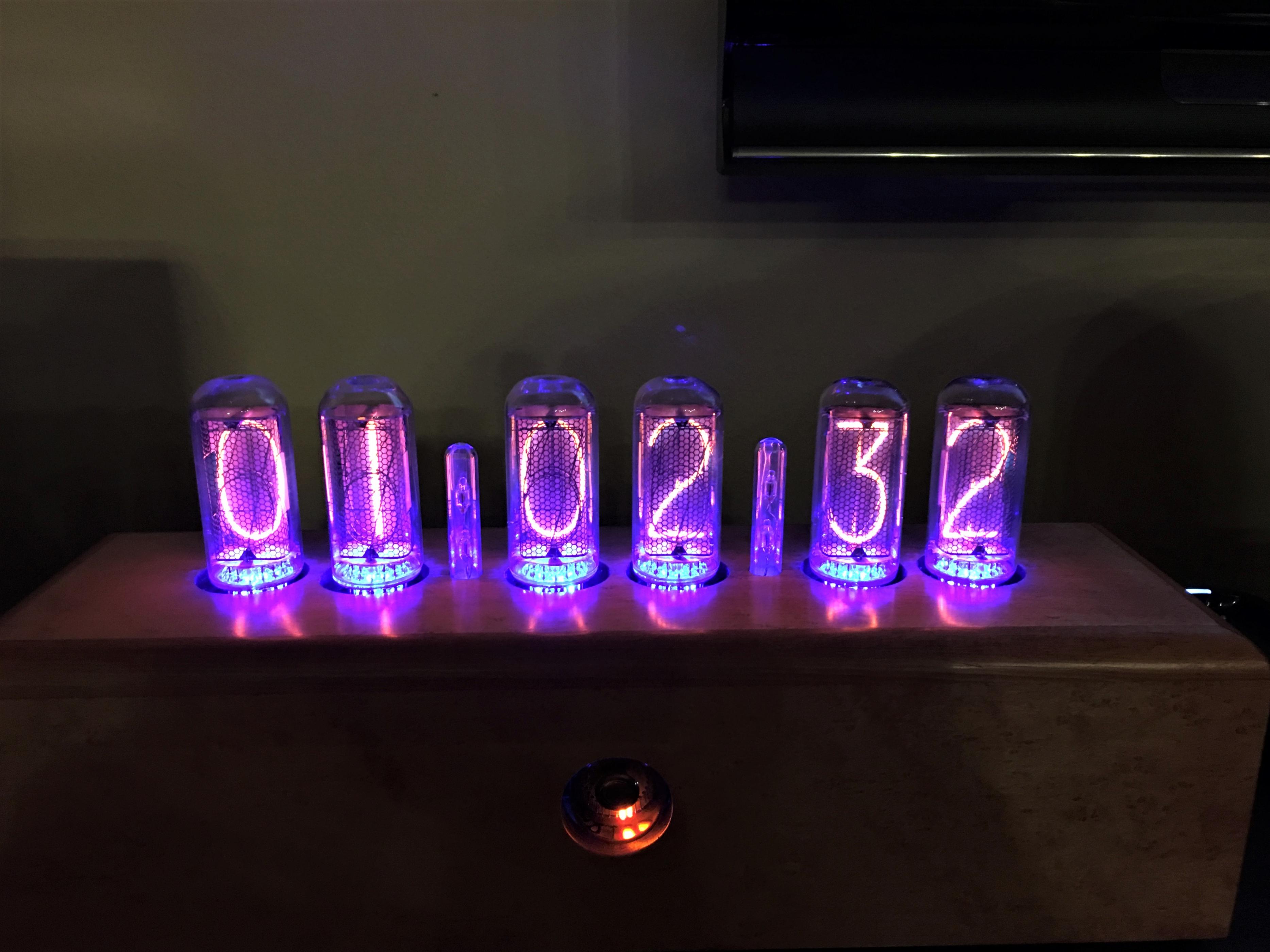

Wow. It works and it looks cool!

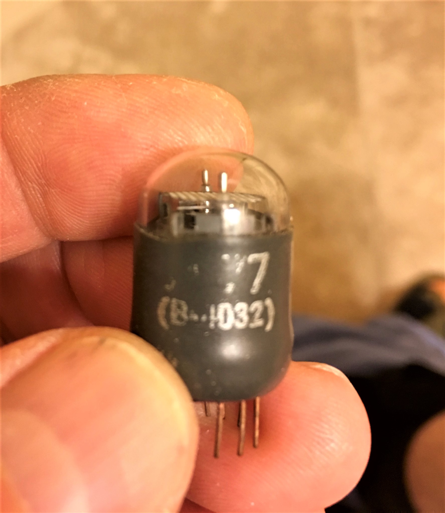

I’ve suddenly found myself with some time over the past few weeks so I’ve got my Nixie tach project halfway there, using Arduino. I haven’t figured out the code piece yet, or how to solder that tiny surface mount resistor to the RR sensor board, but I can get my IN-12B tubes to light up and be controlled by the Arduino.
I’m still interested in supporting your build because it’s super that you have already made it work, and reliably to boot. Sign me up.
