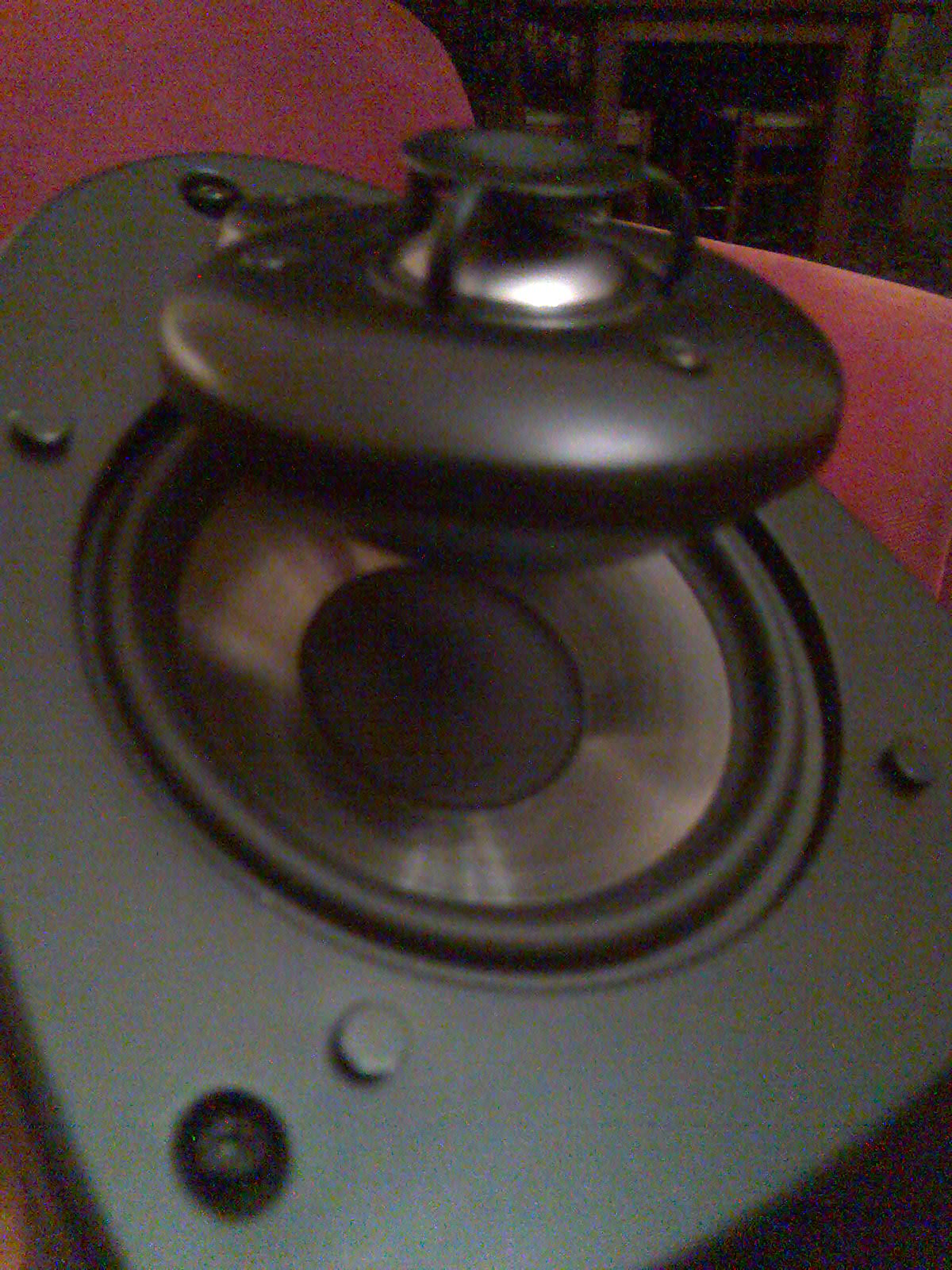

My setup.
Open baffle speakers. Crossovers 100hz & 2400Hz
Room is quite small, 15m2. Wooden house & tilted roof, which makes room related problems small.
Measurement sweep is played "offline" from PS3, and recorded on separate PC. Could this cause "jitter" you mentioned? I have had problems to get decent measurements.. One problem is that OB speakers are ~1.2m from front-wall and the listening position is ~1.2 from back-wall. Too many echoes with same propagation delay? Drc parameter file is Minimum. I have preferred less correction, since Normal settings may sometimes sound like "the band is further away"
Plan is to make measurements again someday..
