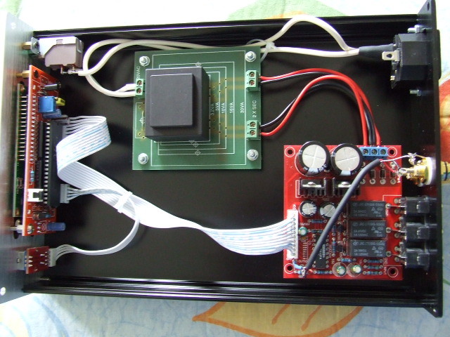

I built this (MCU is programmed):
PGA2311 LCD Volume Remote Control Preamp for 3 Channel Input Preamplifier Board | eBay
