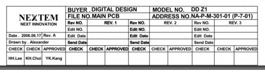

I don't know if the diagram I have is the same as your amp but on this version of the Z1, R229 and C299 are connected between the two grounds.
With the RCAs plugged in, you'd read less than the 1k ohms of R229.
The attached image is the plate from the service manual. Is it the same as the one you have?
R229 and C299 is correct, yes 😉
But the headunit rca ground measures open circuit to chassis ground, as the pico fuse has blown.... and it seems the amplifier really expects this to be tied to ground, otherwise, as you've pointed out, its basically floating (with a 1k resistor tying it to ground)
