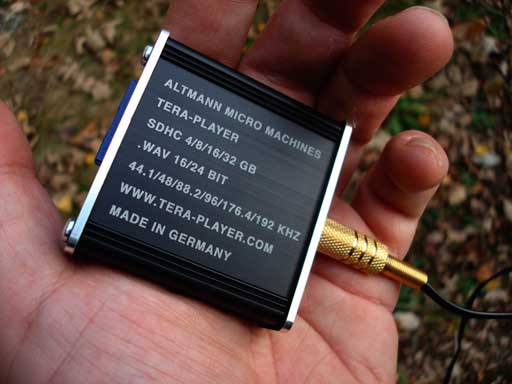

Ah that's news to me - he actually deceives people with his products then in claiming 24bits in the DAC (or just compatibility with playing 24bit files which isn't unreasonable)? Any evidence for subterfuge that you're alleging? I don't have an issue with the price he's charging - if there are willing customers who are happy to part with their cash, can't see anything dishonest there. In any case contributing to this thread by no means implies you endorse or condone dishonest business practices (if they are indeed ocurring). By citing Mr Altmann I don't thereby rubber stamp his business practices. I just use him as an example of someone who has happy customers on one hand and a marauding band of moaners (who aren't customers) on the other telling customers who are more than happy with the subjective results that they drank the Kool-Aid. That's worthy of ridicule.
its printed on the case.... and it doesnt have an asterix* and yes he has gone on record saying it can drive headphones to the fullest, yet its clear he has little knowledge of what that means... he dismisses many better headphones without having heard them in preference to his ideal headphone, which is a modified $30 Koss headphone. The Koss admittedly punches above its weight (it was the first headphone mod I did like 5 years ago), its not equal to the best available and totally useless for portable listening due to being completely open. which you can see with the pictures in his advertisement page
no Charles, hes not pushing them against his ears because he cant get enough of them, hes pushing them against his ears because its the only way you can get any bass/seal.
if you fully read the specification
Supported file type: WAV stereo 16-bit and 24-bit​
Supported sample-rates: 44.1 / 48 / 88.2 / 96 / 176.4 and 192 kHz​
nothing mentioning its only 16bit there. I dont think you can say it supports a file type it cannot actually use
DAC: modified NOS Philips 16-bit R2R with current output​
modified hey? perhaps he added the extra 8 bits in there with a mod? I know the Germans are pretty good with technology....
and
volume control: 32-bit digital
hmmm. hes only recently included the dac type, didnt always mention the 16bit part, he was very secretive about it, simply saying R2R. I guess after a number of us made a bit of a deal about it he added it.
perhaps he only found out after he got the cases printed? going by that logic my iriver supports 24/192 now that its got rockbox on it....
for me thats equivalent to including the potentially poisonous ingredients on a package for general consumption and then blaming the consumer for not reading the fine print. Certainly there are still a number of people who buy it thinking it plays hires if the user threads are anything to go by. many of them even after theyve been informed seem to think it sounds better 'playing' hi-res....

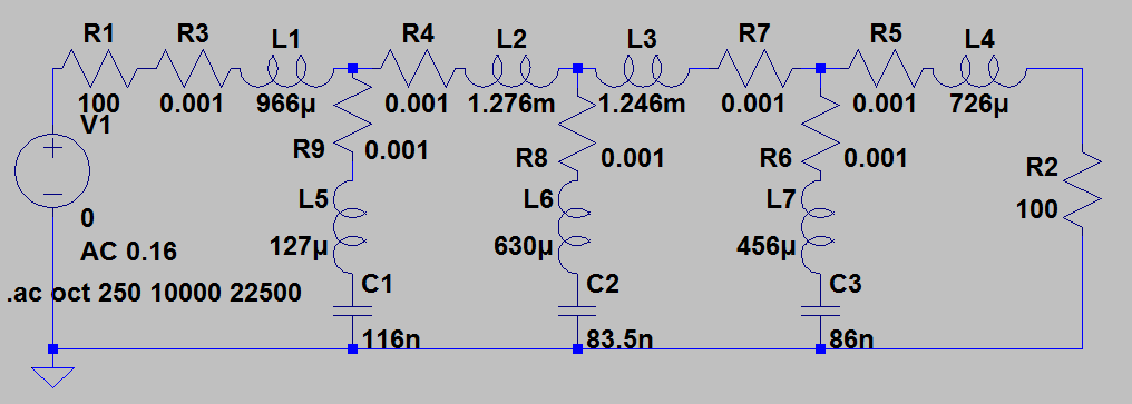

7th order elliptic anti-imaging filter
Here's something one or two of you guys might be interested in - a passive filter designed for NOS DACs. I've read a few reports and agree that NOS sounds a bit rough at the top end - I've wondered if this is due to amps or tweeters creating intermod products with the ultrasonics. So here's a design which I'm currently building to test my hypothesis - a 50dB stop-band passive anti-imaging filter. Ignore the 0.001 resistors, they're just there to see the effects of lossy inductors in running the sim.
