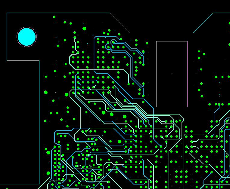

Hi Magnoman,
a recent 14 layer design had the following layer stack:
Top: Top layer components, GND copper pour, some routes
L2: critical signals
L3: gnd
L4: critical signal
L5: gnd
L6: power
L7: signals, some power islands
L8: signals, some power islands
L9: power
L10: gnd
L11: critical signal
L12: gnd
L13: critical signal
bOTTOM: bOTTOM LAYER COMPONENTS, gnd COPPER pOUR, SOME ROUTES
That was a standard PCB, through hole vias from top to bottom, a similar design done using HDI design had less layers due to the extra room this sort of design allows, this had vias top-L1, L1-L2, L2-L3, L3-L7, L7-L8, 8-L9, L9-bottom:
Top components, GND plane
L2 power
L3 critical signals
L4 gnd
L5 signal
L6 signal
L7 gnd
L8 critical signals
L9 power
BOTTOM
the main thing is to run critical signals (high speed, DDR interface, clocks etc) next to a contigous GND or power plane. To do the job properly we may spend 2 or 3 days just entering the constraints into the system, this gives us skew groups (delays between groups of signals), permited layers for certain signals, target impedance etc etc.
There are numerous variations on these builds, and often depending on system rerquirements and costs gnd planes can be added or reduced. A lot of PC cards can be layed out on six layers, with a buit of a struggle as the DDR interface is optomised by the interface IC's for DDR memory modules (the lines are all pretty and sorted out).
Another difference with todays boards compared to the PTH 0.1" dil based designs of yesteryear is routing style, the X:Y routing is not as prevelant, what you see these days is more river routing (one term for it, its Sunday morning so I'm a bit slower than normal, more like Quaps pet than human! today, yeast poisoning). The picture below is an example of todays routing, ie we try to minimise layer changes (unlike manhatton routing) so the traces meander between the vias of the BGA.

Your correct, this is the more extreme end of PCB design, where cost is secondary to reliability, signal integrity and low EMC emmisions. These layer counts can go up depending on the number of pins on any BGA devices, its that crazy that there is even a book on BGA breakout...
BGA Book Download
not the most exciting of reads, unless your faced with a 1000 plus pin device on 0.8mm pitch or smaller.
The biggest problem for DIY at these levels is cost, as well as multi layer they are generaly impedance controlled builds that adds to the cost, and then there is assembly, they are not the sort of boards you can assemble at home, with all the copper layers controlling the reflow profile requires the right kit and a multi zone oven, and all are double sided placement, it is the only way to get the decouplers in the correct place. Prototypes can be a few thousand a panel, production runs depend on volume and location of manufacture.
