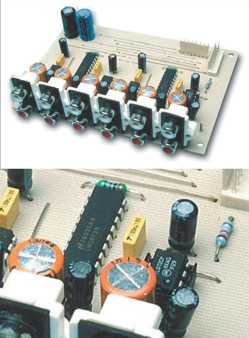

JoshK said:Do you know what that 6ch Vol Control on decibelhifi uses? The wolfson wm8816?
Guys,
I think that equipment is like one that I saw in a Silicon Chip magazine.
If it's so:
Volume control made by 3 x LM1973 and a PIC16F84A, witch controls the LED indicators, receive and decode IR from a remote control and, of course, the audio level of the LM's.
If it isn't... sorry

Hey guys you can buy that 6 ch vol control from here cheaper, i think its in kit form. it seems like a pretty good unit, i got the issues of silicon chip magazine at home somewhere, its got all the specs on it, will see if i can dig it up, but i wont be able to post any schematics on here due to copright stuff.

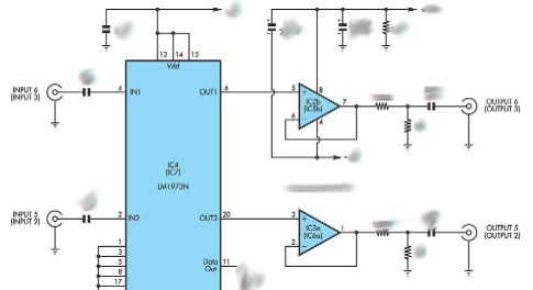

Thanks Pedro,
Looks like a good kit for the money, although Altronics has it much cheaper than Decibelhi-fi. Anyway, not a bad place to start, but I really need balanced in/outs.
Will the LM's control vol on a balanced channel if I change the corresponding opamps to deal with this?
Hope nobody kill me for this...
Look in the schematic:
You have 6 inputs and 6 outputs.
If you need balanced, with one kit you get 3 ch volume control.
Just make another pcb with LM1973 and connect the data wires from the original pcb to the cloned.
Get the idea?
