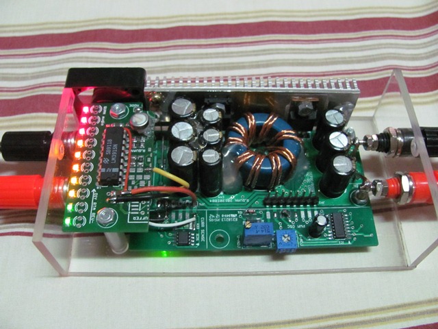

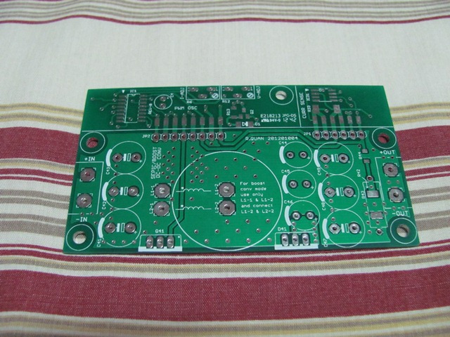

upping a 4 year old thread. Here's my story

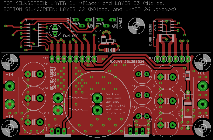

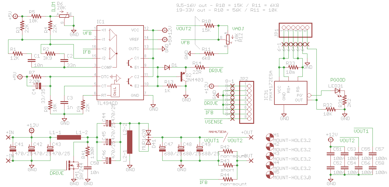

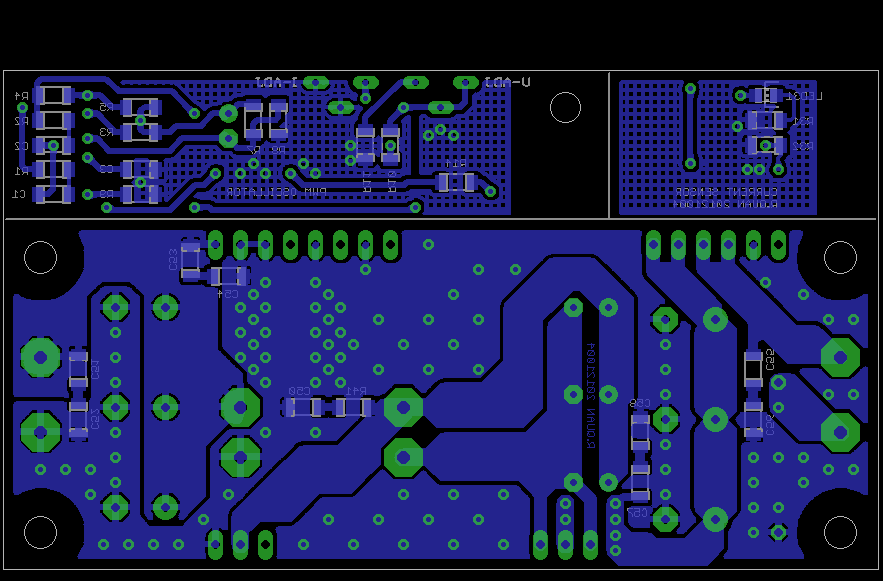

I'm building a SEPIC based CC/CV mode switchmode supply for various applications so I designed and had boards made. some of my planned applications are battery chargers and LED drivers. (see attachments for PCB layout and schematic)
The board uses the ancient TL494 (as I already had a bunch of those) for PWM control, IRFZ44 as the main switch. Hi-Flux core for the main inductor, all Panasonic FM for the input, output and sepic caps, MAX4172 for the high side current sense (can eliminate that and use a low side current sense resistor if output ground doesn't have to be the same as input ground)
The problem:
First application I have for it is a 15Ah LiFePO4 battery pack charger which needs about CC at 3A and CV at 14.60V.
I'm having a really hard time stabilizing the circuit. The CV mode is fine, transient response works well with a small overshoot and there's a small lag at no load to full load response.
in CC mode, current is maintained but the circuit goes crazy and makes buzzing noises. I've been working on and off on this thing for about two weeks until I stumbled upon this thread and the mentioned app notes. Ended up having to add a snubber (3K + 1uF) across R32 to slow down the response greatly.
Once it was slowed down, circuit behaved perfectly. It's actually fine since the load does not need a fast response since in battery charging, the voltage and current does not change quickly. One minor problem I have is that if the circuit is powered before the battery is connected, once battery makes contact, there is a huge current spike as it takes a bit before the current limiting takes effect. If the battery is connected before power applied to the circuit, there is no problem as the circuit has soft start implemented on the TL494.
I can post pictures of the actual unit if someone's interested.
I forgot to add:
The point when the circuit goes crazy is at moderate loads. It occurs well below the point where the circuit goes from discontinuous mode to continuous mode but I tried another coil with more turns and still occurs at approx same current level.
At first, when I wound the inductor using single #18 wire per winding then switching to 20 strands of #31 wire per winding made things much better but the oscillation in current mode persisted but much much less than the single #18 wire. Turn counts were the same. Switching frequency is around 56kHz. I couldn't explain how that happened. It must have something to do with better current flow due to the litz wire at high freq and high current but I don't know much more.
Then I also noticed that the instability occurs at about >2.7A input current. if I increase input voltage or decrease output current limit threshold to maintain 2.7A input current, the circuit is stable without the RC snubber across R32.
The PCB also has options to be used as a boost converter but I don't have immediate application for that so it is not yet tested for that use.

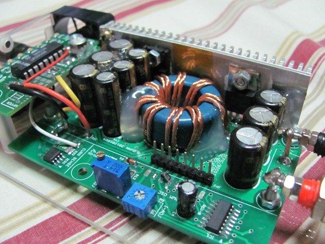

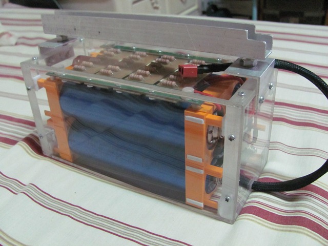

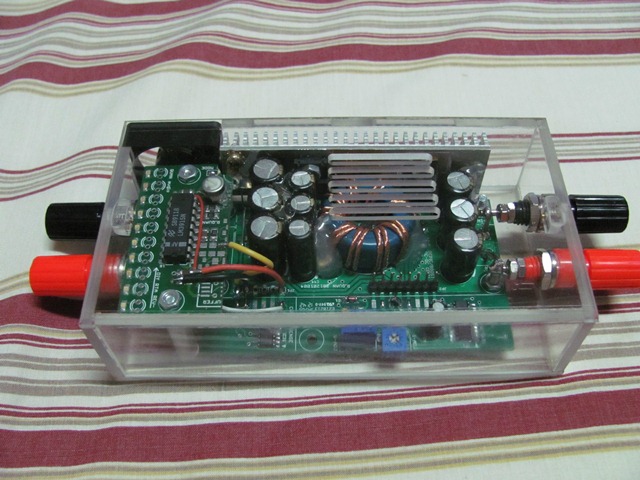

The converter works pretty well now so I made an acrylic box for it.
output is set at 14.4V and current limits at 3A
I can use it for charging the 15Ah LiFePO4 battery pack or providing a constant 14.4V supply for loads under 3A with a 10V-18V input.
