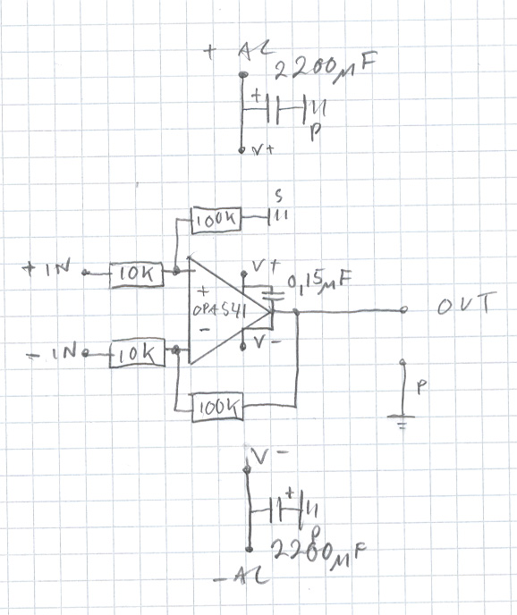

After some search following your explanations i found a member "Mad_K" was interested on this topology at this topic :
http://www.diyaudio.com/forums/showthread.php?s=&threadid=15179&perpage=25&highlight=&pagenumber=5
He has used opa541 opamps in his works and it seems he has finalized his works with this picture.
I think that there is no critical reason for using a LM chip instead of OPA54x power opams. Is it right?

That is correct. You are free to use whatever brand chip you'd like. Keep in mind that the LM chips have a minimum gain requirement of 10V/V while the OPA chips are stable down to unity gain.

Yes Brian, I saw your implementations after a little search also.. But I'm something nervous about using opamps before amplification. Is it possible to pull out them in your schematic?
I want to try Mad_K's schematic with LM1875. It is very simple. If you have any suggestion (resistor values for desired gain etc..) on his approach, i would be very pleased.

Regardless, my schematic uses the LM3875 in a differential configuration, just like MadP's schematic with the OPA541. You can do away with the differential buffer (the dual op amp circuit) before the differential amp if you wish.
