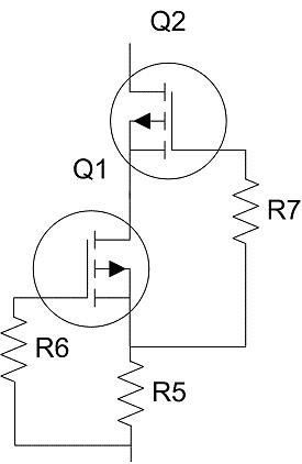

You can use DN2540 depletion mode MOS to do a very simple self-biased CCS with outstanding performance; these devices weren't easily available when "Valve Amplifiers" was written, but I suspect they'll be included in the next edition.
Here's a figure from my upcoming (whenever they actually get around to publishing it) AX article showing how it's done. R5 sets the current, R6 and R7 are gate-stoppers to prevent oscillation. R5 will probably be 200-750R, R6 and R7 are non-critical, 300R-1k will work, but the resistor body should be as close to the gate pin as possible.

I've done a diff amp with 7N7 driving 2A3 . The loads on the 7N7 have a cascode tail set for slightly over 12mA . The anode loads use a single DN2540 CCS set for 6mA , in parallel with this is a 2.2M resistor . The parallel resistor prevents 'fighting' , it's crude but stable and sounds rather good . There is also the option to drive off the lower impedence 'mu' output from the DN2540 source pin , although I've not tried this yet .
