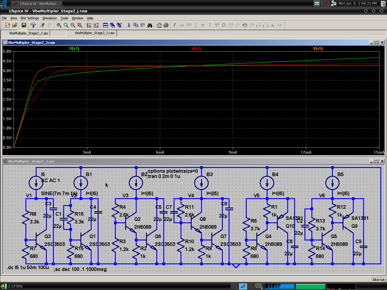

Here is a DC sweep plot of those circuits.
- keantoken

Most designers treat the Vbe multiplier's impedance as negligible. However a small electrolytic shunting one will only cover the treble and maybe midrange. While I have no subjective experience here, there seems to be a consensus that you want impedances in an amplifier to be flat through the audio range.
The two diodes will work for thermal considerations but will (estimating) drop the impedance by about 1/3.
- keantoken

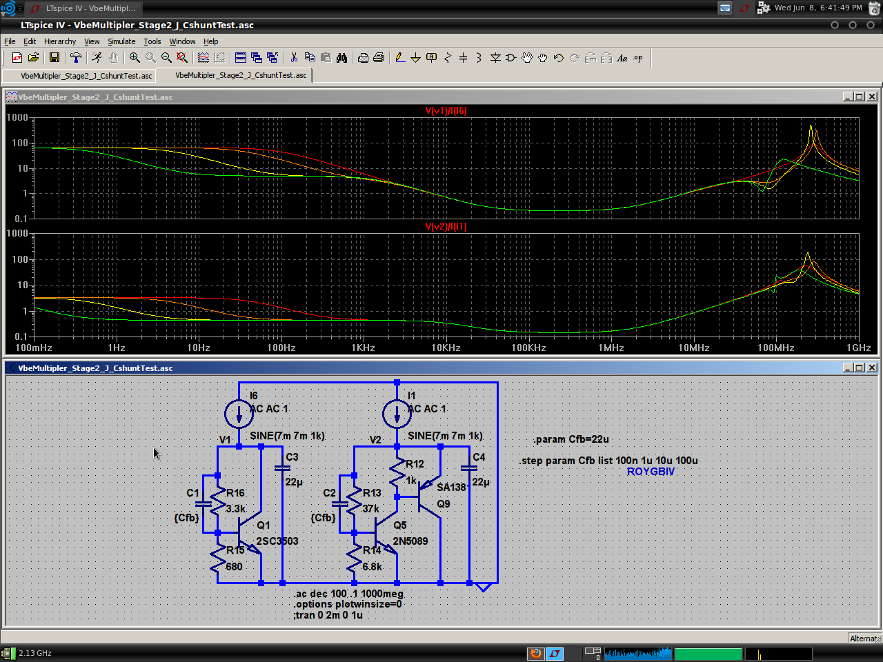

The cap in the feedback loop has different requirements depending on the feedback loop resistance, so it is not a good reference.
Here are two simulations. The first steps the value of the shunt capacitor between the values of 22u, 47u, 100u, 220u, 470u, 1000u. We can see that for both multipliers, you need an enormous shunt cap to cover the audio band.
The second shows a way to use a smaller cap to decouple the first resistor. Values simulated are 100n, 1u, 10u, 100u. The effect can cover the whole audio range with a reasonably sized cap, but the impedance of the multiplier will be larger than it would with the shunt cap. For comparison a 22uF shunt cap is included in this simulation to show the qualitative difference. With the shunt cap, impedance is less but only in the treble region. Because of the low Ib of Q5, the divider network resistance for the second multiplier can be increased by a decade, and this makes the cap trick 10 times better; now a small film cap could be used.

As if to spite me, I did a transient analysis (as opposed to AC) of the last image I posted, and discovered the first multiplier oscillating! Hell, I'm discovering anything can oscillate, even a current mirror (in real life). I suppose the question is not whether you're paranoid - but whether you're paranoid ENOUGH! *grumbles incoherently*
Have you thought about Hfe/Ib tempco? If a low gain transistor is used for the multiplier, this might change things up. Is it possible that the Ib tempco of the multiplier may compensate for the Ib tempco of the outputs/drivers through the base stoppers? With some math, one could adjust the divider impedance... I haven't tried this in simulation, but thermally accurate models would be necessary.
Also, as per my last post you might try increasing R101/R102 by a decade, along with the trimmer... Probly doesn't matter though...?

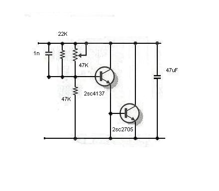

OS, I just realized it would be simple to just put another trimmer in series with the base of the NPN and set the divider resistance at a reasonably low value.
My idea is attached. Tempco can be adjusted without affecting the quiescent currents of the transistors. This way one can always use a set of transistors known to not oscillate.
- keantoken
Yes , that would work. 🙂 It is essentially the same as changing the fixed resistor's values(without changing the current). Some would see it as too much trouble to have 2 Vbe adjustments. However... having this setup to use in a prototype would allow one to really fine tune for the final thermal solution.

That circuit will do the job, but not much better than a single-transistor multiplier. Furthermore, if the trimmer disconnects, the output stage will be left at highest bias, which is not good. This is why it is safer to use the lower resistor as the trimmer.
