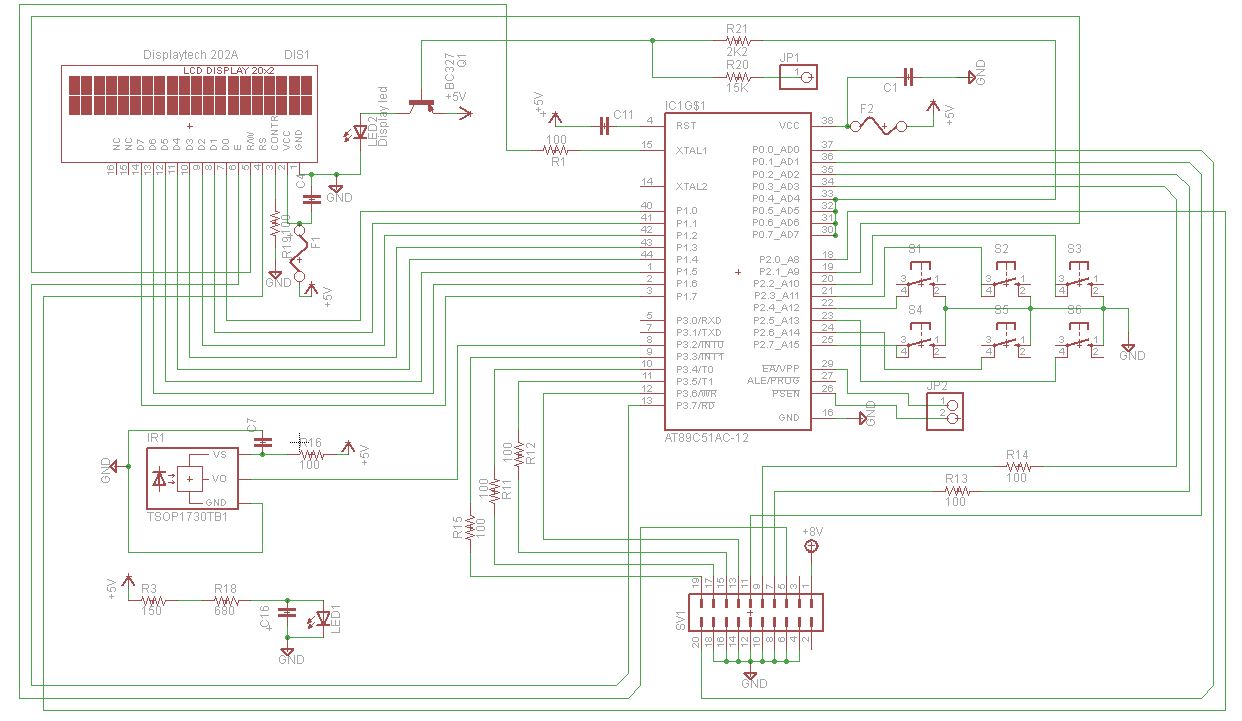

I have been trying to find the fault in my control/display board withou success. The microcontroller seems faulty or has lost the flash program.

Display PCB schematic (unfinished)
This is the display PCB schematic not finished. I imagine the clock signal comes from the servo board. There is a 10-way connector not included. The purpose could be for progamming the flash memory. I don't know if the mechanism uses the DSA protocol.

Hi Contax,
Yes, it’s a design issue internal to the Philips 8051 - they can under certain conditions wipe there own internal Memory!!! really useful! So most likely its memory’s been overwritten.
To prevent overwrite; the modification was to replace the series termination resistor inline with the MCU clock input with a 0805 100pF capacitor (or might have been 0603).
If you send me your front panel, I can reprogram it – or do you have an 8051 programmer – I could send you the hex file…
