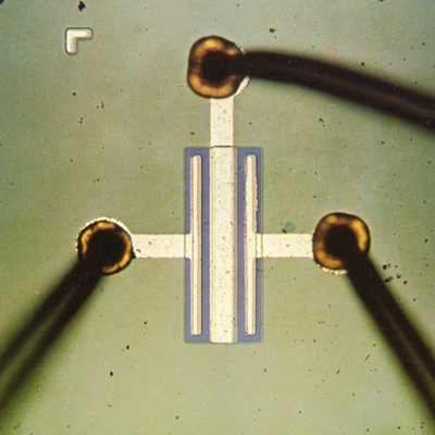

I was at Fairchild Semiconductor in 1966 and picked up these unmarked devices in the engineering department. The die in the pic is in a TO-72, which has 4 leads, one is the case and the other three go to the die. The die is about 0.5 mm. What is the device type and what are connections?

A NPN/PNP transistor has a collector , base and emitter , Looking at the transistor the second pin would appear to be the base (or the P or N in a NPN or PNP transistor) the other two are either the collector or emitter .....
Put it in a basic transistor curcuit with a socket and try it both ways and see which one works and you should be able to figure out the pinout from there ....
it is most likely a NPN if it is from the 60"s ......
You might also be a ble to deduce the pinout with the transistor setting on your DMM .....
Cheers
Are you sure that's not a FET with both gates leaded out?
I think you are on to the right track thinking it's a FET. In the '60 we called them MOST....for Metal-Oxide-Silicon-Transistor. MOST never caught on, MOSFET is a better acronym.

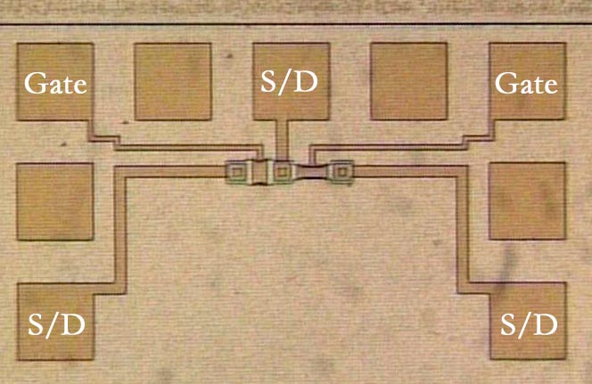

This is a dual gate MOSFET die, my device has one gate.
