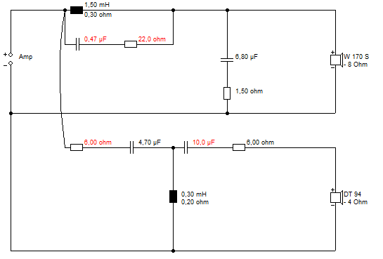

I'm thinking butterworth, as below but I've really no idea what the levels will be. 15 litre closed box for sure though and you'll need to deal with fibreglass cone breakup....

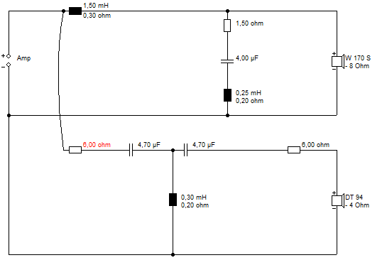

System7, is that a 3d order Butterworth? How well would it match up with the older Focal in your opinion? ..... What I've been show is a 16 res connecting + and - : then a 1 ohm res on the + : next a .5mh between + & - : and finally a 15uf on the + line. What program did you use? What's your home audio equipment and speakers?.. my XO may be wrong so I'll have it checked again. Thank you for your time and effort..

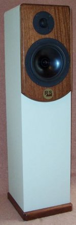

For the two designs that used the XT19 tweeters, both were 3-ways that used a 2" dome midrange, one an MDM55 and the other an RS52A. I no longer have either of those pairs of speakers. My electronics consist of a Linn Wakonda preamp, Linn Ikemi CDP and Quad 909 power amp, and I also have an HD Radio tuner for local classical music on FM. I generally only build 3-way speakers but my current speakers are 2-ways using an 8-inch, RS225-8 with an RS28F tweeter, called the RS duets, with the cabinet being a mass-loaded TL. I've attached a photo of the RS duets which won first place in their category at last year's MWAF.

I am entirely following my intuition here and a frequency response from Monacor for the similar SPH-165CP.
On second thoughts, a standard sort of 3kHz bass filter is indicated for the extended response of a Glass Fibre cone. I really have no idea about tweeter level, and the second tweeter capacitor of 10uF would be better if the tweeter is less efficient than I guessed and the input resistor is smaller than 6 ohms. It's just how filters work. And this is diyaudio, after all.
The 6kHz tank across the bass coil might straighten out the phase a lot on a flat baffle. But I'd think this is all doable with some fiddling on resistors. The bass filter won't be a million miles away from where you want to be. Listening will determine the tweeter filter details. Best I can do in such a vague situation. 2nd order bass, 3rd order tweeter should work well.
