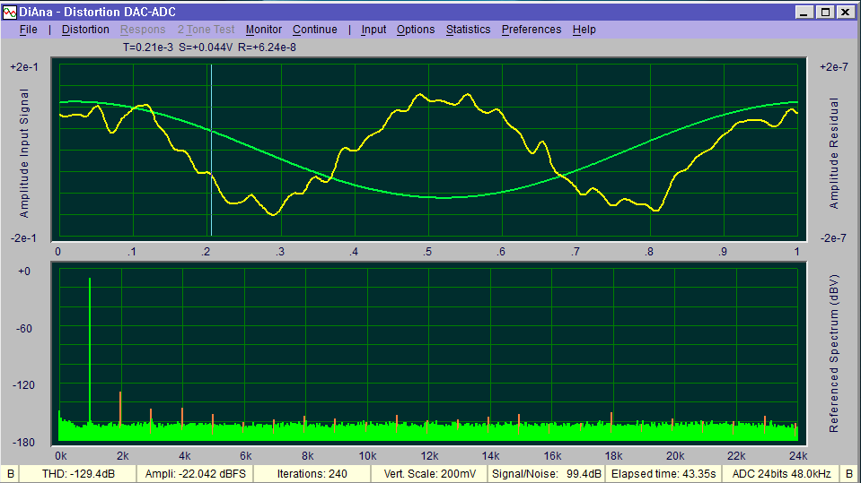

Edmond,
I have download the 1.58.9 Diana version to try it with the RTX6001 Analyzer.
First, I tried with asio4all driver a loop-back measurement @48KHz.
Using a DAC and ADC for synchronization: THD = 119.4dB.
Using the "bypass" method of synchronization: THD = -129.4dB.

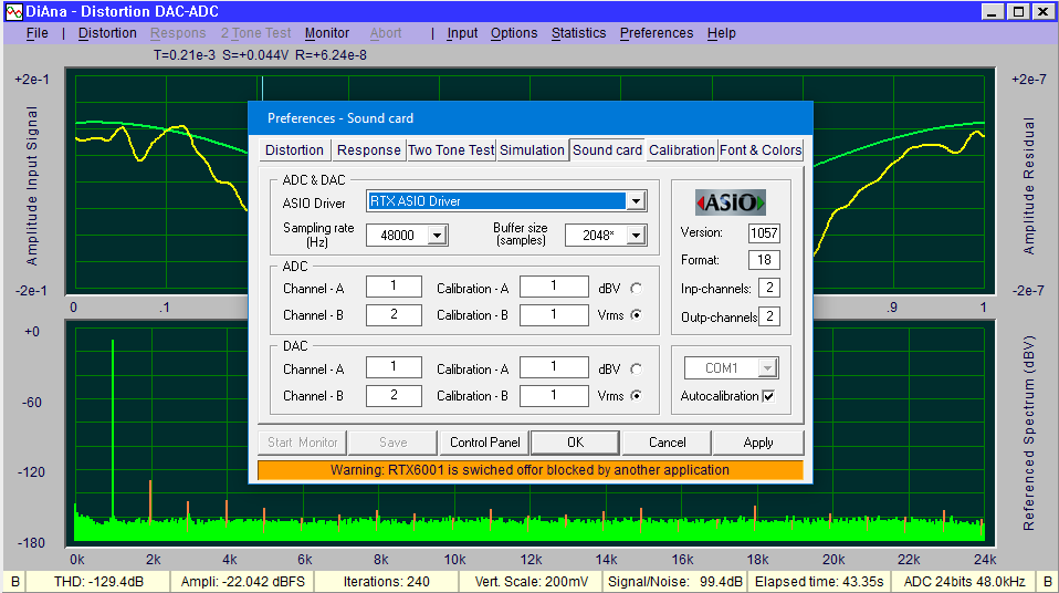

The asio4all couldn't to measure at 192KHz for some kind of reason, so I tried to set the RTXAsio driver but always I had the same error (see attachment).
I closed the RTX usb utility from the tray but with no lucky.
How can I use the rtxasio on Diana (Win'10)?

Hi Manolis,
Firstly, try V1.58.10. But I also had sometimes troubles with the RTX, depending on the switch-on sequence: First PC on and then RTX on, or just the opposite way.
Cheers, E.
PS: No issues when running in "normal" mode, i.e. without by-pass?

I tried the V1.58.10 and I followed your directions but with no lucky, the same message all the time.
Any ideas for the next?
The asio4all works well until 176.4KHz, at 192KHz there are artifacts on spectrum area and the results are very low!
Hi Manolis,I tried the V1.58.10 and I followed your directions but with no lucky, the same message all the time.
Apparently. the communication with the USB port is blocked for some reason*. However, you can circumvent this message by disabling the USB port altogether (as far as the settings of the RTX are concerned). Just remove the check mark at "Autocalibration" in the "Sound Card" menu (only accessible when the RTX has first been selected). Now you can set the calibration factors manually, but should be, of course, in accordance with the gain settings on the RTX.
BTW, what OS are you using and how fast is your PC?
Cheers, E.
* It also might be possible that DiAna couldn't find the USB port of the RTX. If that is the case, a more appropriate error message should have been appeared, of course. This will be fixed in the next version of DiAna.
