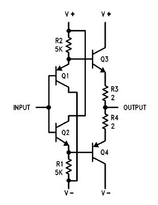

Thank you. The advantages you list are indeed true, and the circuit is not significantly more complex. I just find the symmetry of the LH0002 circuit intriguing, and am willing to pursue it out of curiosity to see how it sounds.
One things I just realized about the LH0002: there is one big difference between an integrated chip like the original and a discrete version, and that is for the chip all four transistors are at the same temperature, with thermal feedback between driver and output. If the output is running colder (less current) than the driver, the driver tends to heat up the output, increasing the output bias current. If the output is running hotter, it tends to heat up the driver, which acts to cool the output by reducing the output bias current.
That's pretty neat, and I'm running into problems right now because my output transistors stay colder than the driver transistors. There's no thermal feedback to keep all the transistors at the same temperature.
I should try and redesign the layout to have the driver and output transistors back-to- back in physical contact.

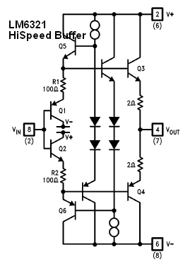

rjmHere is LM6321 HiSpeed Buffer
Has also 2 Ohm resistors.
R1, R2, 100 Ohm are used to set bias current in output.

0.010% THD is not impressive for a buffer stage.
It is not bad. But it is higher than it could be.
If you run output stage in true Class A.
I get .01% for 1 Vrms into 15 ohms.
Walt Jung's circuit managed .01% for 1 Vrms into 150 ohms.
I'm pushing ten times as much output current, and ten times the output power, for the same distortion.
As presently configured, the class A output power is less than I planned, only 1 mW into 16 ohms, because the board layout doesn't thermally couple the driver and output transistors. This will be addressed in the next revision, but the measured performance of the prototype version is sufficiently good that I will give it a full listening evaluation before proceeding.

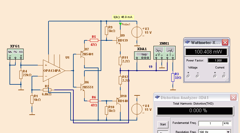

Here is a buffer that gives THD 0.002% into 32 Ohm at 50mW open loop.
It is Class A with plenty of current.
So in such a circuit, to get like 0.010% or lower dist we have to make bias very heavy.
Here it is 117mA.
Colsed loop shows very little THD, of course.

As I recall you use BD135/136.Are those are your simulations? If so could you change the values slightly to match my circuit and compare? I'd like to know how close the simulation comes to the measured result.
Thanks-
I use +10.8/-10.8 Volt supply
Resistors: 340, 0.25 Ohm
I get much higher THD.
So, in this case it is no good simulation.
Any thoughts as to why the simulated distortion is higher than in the real circuit?

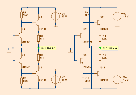

The only difference is I was using a 47 ohm in series with the 15 ohm test load. So while the output current was the same, the transistor voltage swing in my case was 4.1x higher. That and I had 1 ohm for the output emitter resistors at that time.
The 29 mA bias through the driver transistors is exactly as expected. So far so good. The bias current through the output transistors is showing 37.8 mA, which is odd because R3 and R4 reduce the Vbe of the output transistors by almost 10 mV compared to the driver transistors, so the current should be about 20-25 mA not 37.8 mA.
Unless the simulation tries to account for the output transistors heating up from the output current? That is the only explanation I can think of...

The simulated distortion is much lower than in real life.
The simulation gives ~0.12% THD for 1 V rms into 15 ohms. I measured an estimated ~0.01% THD for 1 V rms into 15 ohms. The simulation returns the higher value.

Perhaps my adding the 47 ohm output series resistance reduced distortion by lowering the thermal load on the transistors, or perhaps the simulation over estimates the effect?
Lineup: try running the simulation at 0.2 Vrms output rather than 1 Vrms, this will put the output in Class A operation so the distortion figures should suddenly improve dramatically.
