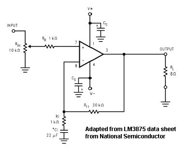

The design is basically an application-sheet design (see below), but it is in inverted configuration.

Here is the non-inverting version from the spec-sheet:

Does the spec sheet for that chip suggest any kind of inductor
or zobel network of some sort on the output? It could be very likely that, due to a reactive speaker cable, your amp is oscillating at high frequencies, generating heat in the OT devices in the chip since they cant turn off fast enough at that frequency. In other words, you might want to try putting zobel network on the output of the amp before the speaker, it consists of a resistor of about 10 ohms and a capacitor of about 100nF in series from the OT to common ground. If that fixes the problem, then your amp almost certainly was oscillating:)

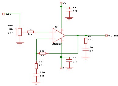

Here's a pic of your amp with a zobel net attached, it's really easy to add on, heh, you could even add the network right at the speaker jack if you didn't want to open the box if it has one...
EDIT: never mind the caps labeled "1n" on the power supply rails, my diagram editor just picks that as a starter value and I forgot to change the them;)

I just did a refresher course on Zobel networks, and I think it might solve my problems. If I am understanding this correctly, high frequency oscillations can occur when there is an absence of load at high frequencies. This is consistent with my "purge the system" volume burst that eliminates the symptoms temporarily. The distortion seems to appear the most when the signal level is at its lowest. An RC Zobel network can reduce these oscillations. So does adding an inductor in series with a resistor at the output just cut off the high frequencies at a level lower than the oscillation? Which one of these fixes would most adequately address my problem? (I would ask which solution would degrade the sound quality the least, but at this point I'll take any clean sound I can get! :cool: )
Sorry to bother everyone with elementary electronics, and thanks again for the help. I should have the parts in hand tommorrow to try the Zobel.
-f4
Hmm, just read up on this thread again. You can use an inductor and resistor as well, some people even put it in with a zobel at the same time. The zobel however, will deliver higher sound quality and is used by many of the better amp designers. Though, you can design an inductance network that won't really reduce quality, but it's a bit harder and I wouldnt consider it worth it.
