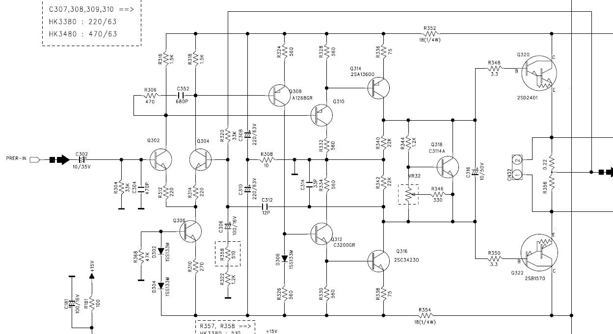

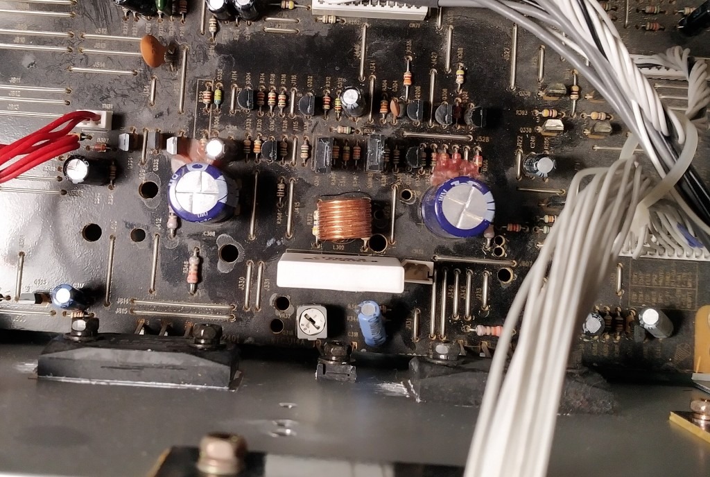

I had some irregular cracking and hissing sounds on my Harman Kardon HK 3480. Thanks to the tips and ideas on this and other forums I was able to track down the problem to the right channel in the power amplifier. I tried tapping the transistors and capacitors but this didn't enable me to exactly localize the culprit component. Wherever i tapped I got cracking noise. (I even tried adding some vibrations with an electric toothbrush but without avail). Not having a soldering iron with temperature indication I was reluctant to heat the transitors because I didn't want to damage them. Nor did I have any freeze spray around. I had the idea to very slightly bend the transitors (the ones not on a sink) forwar/backward. This solved the problem! Unfortunately I bent all 8 of them at the same time so I wasn't sure which one was the culprit.. I tried putting them back in their original position but this didn't reinstate the cracking noise... So i repaired the receiver without repairing it :).
Most likely there is an issue with the soldering somewhere but an inspection with a magnifying glas didn't show any damages. I closed the receiver back up and it has been working a week now without issues.
If the problem would re-appear in the future I will simply revisit those 8 transistors and bend them slightly one by one, checking every time if the cracking is gone. If gone, the last one I bent will be the one with problems.
