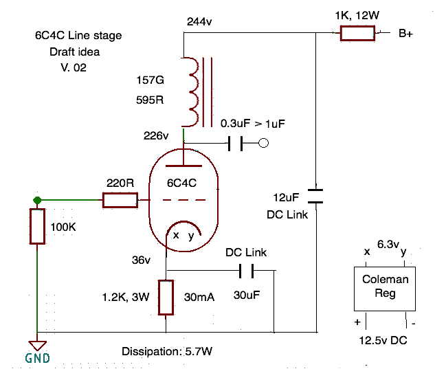

Update - I've been listening to this 6C4C preamp for a few days now and it's growing on me. What I am liking is that it is very clean and no overload on massed voices and the like. I think this preamp will stay in my system for a while.

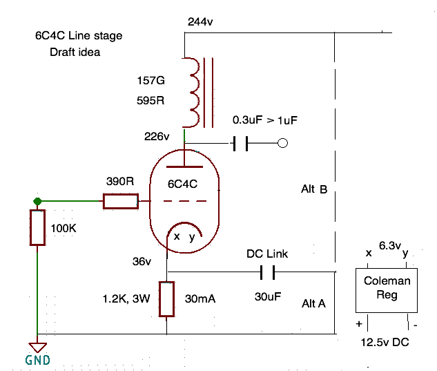

Happy New Preamp! The Slope (gm) of the 6C4C is quite low, so a lower value of grid stopper should be OK. Or a multi-turn ferrite bead. Risk of oscillation is also lowered if another DC-Link cap is used at the DC-in side of the choke, wired directly to the cathode-bypass cap.
Thanks Rod, I took the grid stopper down to 220R. I could probably take it lower. So you are suggesting both a cathode bypass cap and another cap connecting the cathode to the HT at the top of the plate choke? Never tried that. What's the reasoning behind this?
I have the preamp up and running with 25mA going through the 6C4C. My target was 30mA so I can play about with the operating point. The Hammond 157G is a cheap and cheerful plate choke, 30H at 40mA. I should swap in a pair of my amorphous ones to see the difference. Smoother treble probably.
The sound is pretty much as before - very solid with good dynamics and a neutral and what sounds like a pretty even frequency response. It's more transparent than I expected - it doesn't change the sound too much. The treble isn't quite as silky, which is something I'd need to look at. But there are some benefits in dynamics and fullness and body of sound. There's something to be said for a beefy tube stage, even on the input.
Early days - I've only played a few tracks. But I think this has good potential. The output impedance is usefully low on a 6C4C so a plate choke can work - keep it all very simple.
