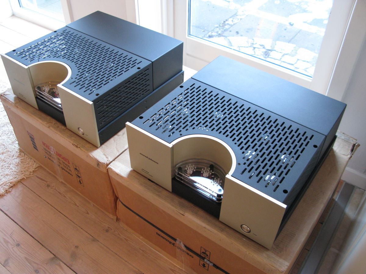

I use conrad-johnson LP-275 amps... Lot's of tubes, but not a single transistor in those and to be honest I don't believe there is such thing as an ''amp match issue'' with the Tram... This preamp has a resistor network on it's output meaning that the triodes in the Tram ''see'' the resistor network as the load, and not the power amp. You can argue that the resistor network can be a good or bad thing, but one thing that is does very efficiently is to ''isolate'' the tubes in the Tram from the power amp. This is different from just about any other tube preamp on the market since most tube preamps are very sensitive to ''amp matching''...
