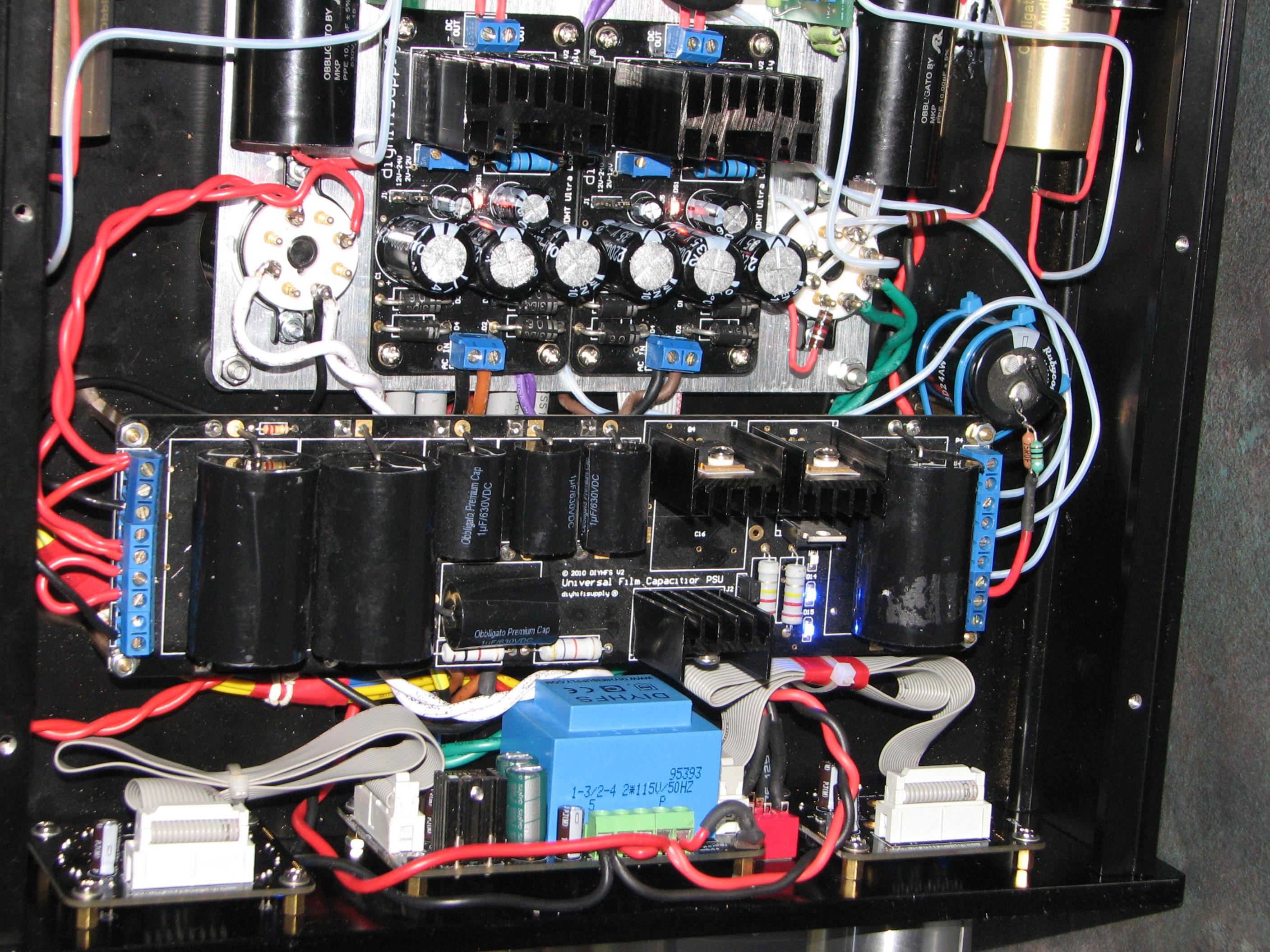

I have just bought a readymade Tram2. Unfortunately I´m having some trouble with the startup and I would be grateful for some advice.
My Tram is set for 230-240 volts. I have followed the Tram manual (vers. 1.36) “Post build up Testing & Adjustment” and gone through the first 9 steps. I have the following notes:
Step 1 & 2 is OK!
Step 3 No tubes are inserted and LEDs in the front are OK!
Step 4 “Under the chassis you should see one LED on the FCUPS Module light up”
I don’t see just 1 LED light up. I can see 2 or 3 LEDs light up at different times. I don’t know if this is of any importance?
Step 5 & 6 “Use a multimeter to test the heater voltage as shown for one channel. Adjust the multiturn potentiometer (highlighted to the right in cyan) to the lowest voltage adjustable, this is normally around 2.7V”.
I measured 2.8V and I adjusted to 2.7V on both channels. I can adjust it to less than 2.7V but should I really do this?
Step 7, 8 & 9 “Switch the Tram off and back on. Test immediately after switch-on between ground (marked black to the right) and the grid of the left channel tube (marked red to the right). You should measure around -65V (+/- 10V). Repeat for second channel.” For both channels I measured -163 V between ground and grid. I then switched the Tram off. There are some things that don’t work according to the manual and I don’t know what´s wrong. I have contacted Diyhifisupply but I got no answer yet
Does any of You have any ideas?

Hi Mats,
Welcome to the dark side of DHT preamps :)
Heater voltage:
Adjusting to 2,7V with no tubes is fine. This is just to get the heater voltage ''about right'' before inserting the tubes. When you have the preamp up and running, with tubes, you should let it warm up for at least half an hour and then make fine adjustment of heater voltage to 2,5V.
Grid voltage:
Check if the wiring and the resistors around the Auto Bias module is correct. When power is on, the auto bias module pulls down the grid to the negative voltage of around -65 volts (+/-) and then the voltage gradually goes up to the operating point over several seconds. This is to make a soft start on the DHT tubes. That your voltage is much lower could indicate something with the wiring or the autobias module. Try to check if the voltage stays at the -163V? Or does it gradually rise..!? Is this in both channels..?

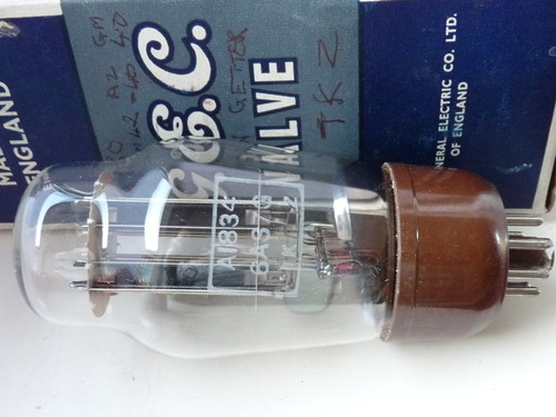

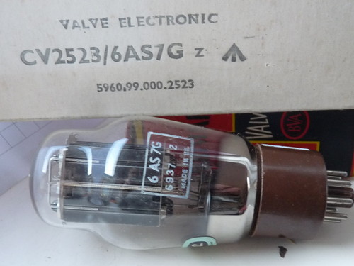

Morten, the next tube to work on is the 6AS7. GEC make some very nice examples. They are designated GEC Straight or curved Brown Base 6AS7G A1834 CV2523.

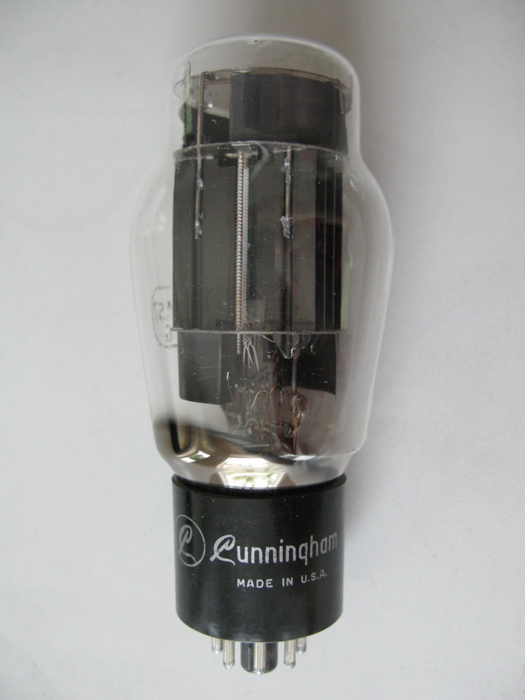

That is done Peter...
I use a very, very nice sounding Cunningham tube at the Mu position. It sounds and also look amazing because the glow of the heater is so strong and visible through the internal structure.
At this point I can't really think of anything else that can be improved on my Tram II... And it sounds amazing..!

Hi Peter
Thank you for your replay
All LEDs D13, D14 and D15 lights up after about 30 sec. D15 is a bit "weaker" I think. I have measured again and got this result:
"In wall" 230V AC
FCPSU Module
Both "RED" 204V AC to "DLK-"
Bias -174V to GRD (stable)
B+ about 320 V ..... and rising (just before i turned Tram off).
(No tubes)
BIAS module
Bias -174V
Purple cables 9,7V AC
And same as before between ground and grid -163V. After about 10 sec it´s stable. After a while the voltage starts to sink. I desided to turn the Tram of because of the high voltage at the FCPSU so I have not mesured how low it goes.

Hi Morten,
I have checked the wiring and resitors and they seems ok. I have also done some more mesasurements which I have just posted.
