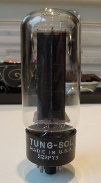

.... Im getting Morten's Russian rectifiers:
,,,,Morten did you get the older 1950's/1960's black plate type as reviewed here?
Eventually Peter and I might be able to compare the U52 vs the Russian.
A data sheet for the U52 states its a "half wave rectifier" while the 5U4G is a "full wave". I wonder what that means and if it would make any difference to the sound?
Hugh and Morten, the Russian 5U4 rectifiers pictured, sound very average compared to the GEC U52 tube. The U52 tube was extremely quiet and extremely musical. I did not believe it until I heard it myself. There must be other musical rectifier tubes. If anyone has tried the U52 and other 5U4 equivalent tubes, please speak up. The GZ37 and GZ33 tubes are interesting as promising alternates.
Peter
Peter
I wonder how the U52 will sound with the Coleman Regulators and 2A3 tubes?
The GEC labelled U52 brown base, black plate, 'D' Getter with manufacturers 'KB/Z' rectifiers has a fast dynamic sound which Steve Garland who has heard my Tram2 said this tube would be a very good combination in my system. The Osram labelled U52 with brown base, black plate, 'D' Getter without the 'KB/Z' labeled have a lush, full bodied and slower sound. It all depends on your taste of how you like your music to sound. I will ask him on his pick of non U52 tubes that would suit the tram2 pre-amp. More later.
Peter

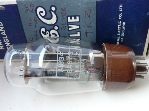

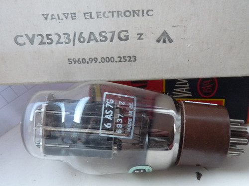

Has anyone had experience with the A1834 (6AS7G or CV2523) GEC or similar tube. They come in straight or curved brown base. See attached pictures for details.
Peter
