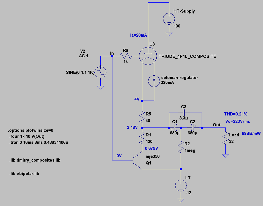

Hi everyone,
After reading Broskie's hybrid CF+ post here, I decided to play around with the 4P1L triode-strapped DHT and LTspice to see how this circuit may perform for my Grado SR80 headphones which are 32 ohm.
In the attached simulation you can see that simply with one tube running at about 20mA you could get around 0.21% THD when output level is 223Vrms at the 32ohm load. With a sensitivity of 89dB/mW, this would be more than enough as maximum level or am I doing the maths the wrong way here?
This will need just 770Vrms at the input, so will need to add a stepped attenuator and will get a simple headphone amp with this setup.
Any suggestions before attempting a breadboard of this circuit?
Ale

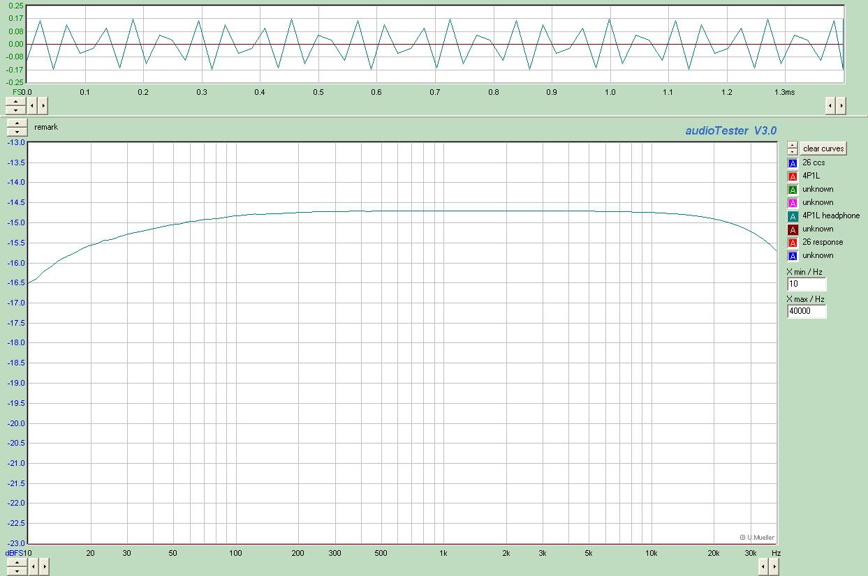

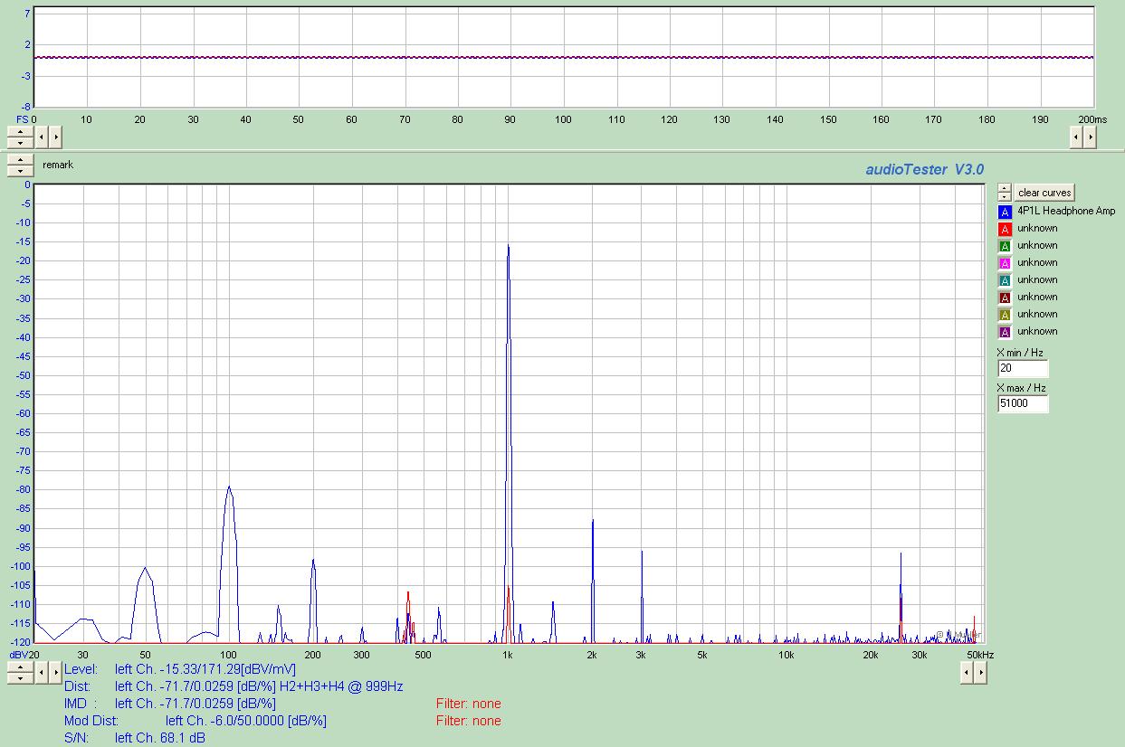

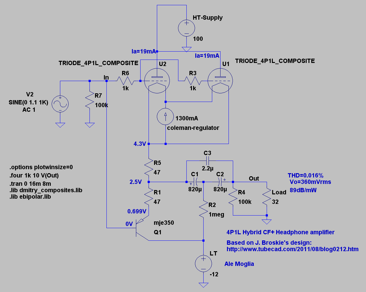

Today I finished the breadboard version of this amplifier. I decided to parallel two 4P1L to achieve lower output impedance and minimise distortion. In LTspice it performs really well: THD=0.016% @ Vo=360mVrms.
The bipolar capacitors are OSCONs and the value was chosen due to the availability (the -3dB corner is around 5Hz).
Haven't used in this breadboard the Rod Coleman's regulators. Just a good regulated DC supply.
My old bench HT power supply has a significant ripple when dragging 40mA so ended up adding a 470uF electrolytic to minimise the 100Hz bump. See attached.
When testing this circuit, I lowered the HT to 90V to achieve 40.8mA of idle current across the two triodes. When driving it with a 1Vrms I got THD=0.026% @ 484mVrms (1.52Vpp). When tested with the headphones, maximum level for me was around 80mvrms, so distortion is really good.
No ringing issues in CF mode. A bare minimum when you tap the valves. Remember that my grados are 89dB/mW :)
Sound is warm. If you run the amp at lower than 40mA you get the third harmonic higher than the second. To me the PNP transistor doesn't seem to add any colouration to the sound. It's pleasant to listen to and quiet. This can be improved with a proper HT supply to minimise the ripple
I need to build this properly now...
