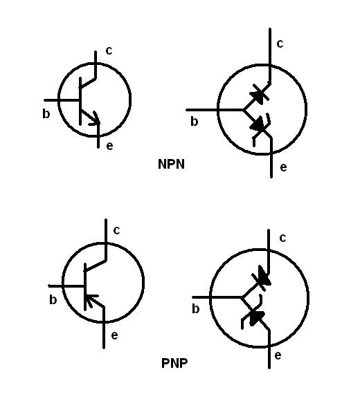

I use methods in posts #4 and #8...same end result.
See jpg...transistors measure like diodes with dmm (or vom) set to diode scale.
I have found that the red lead provides positive output but check your dmm or vom before using.
I use a 9V battery and a 1K resistor to find the emitter.
