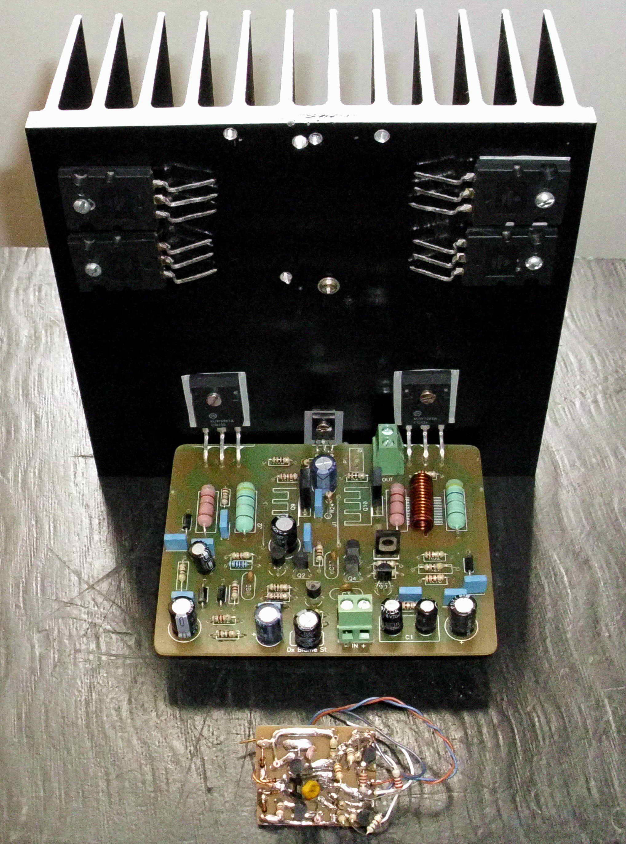

Destroyer x Amplifier...Dx amp...my amplifier
Here is the board Herman made for us
This way i can understand much better.
Values directly printed over the pcboard...without part numbers.
In the future we gonna have a thread only for that...for a while i want to associate with the Dx amplifier and the Dx Blame ES and ST..... in the future i will open another thread.
regards,
Carlos

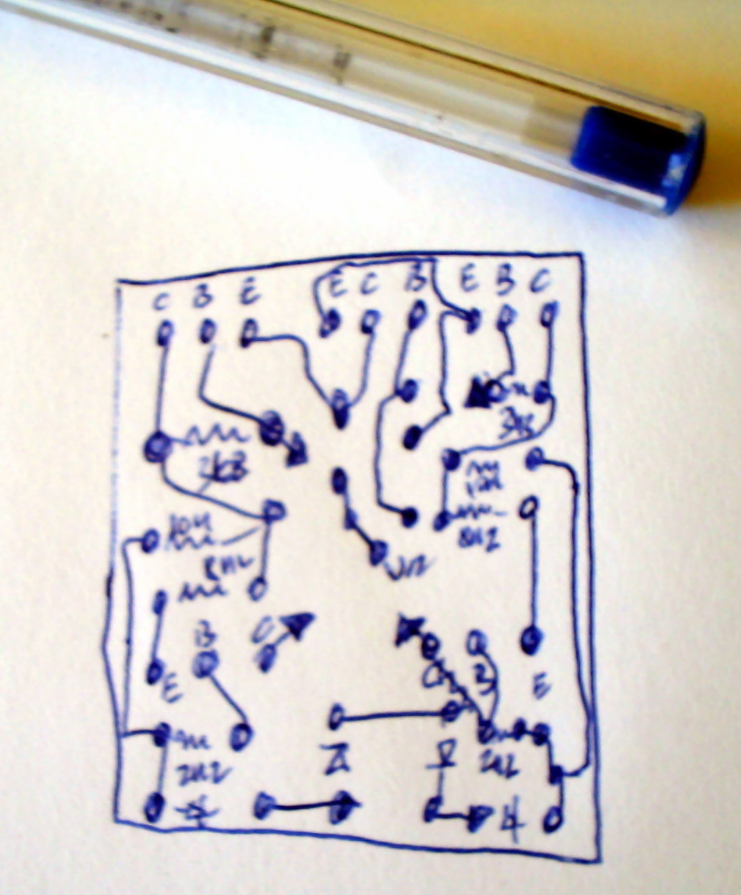

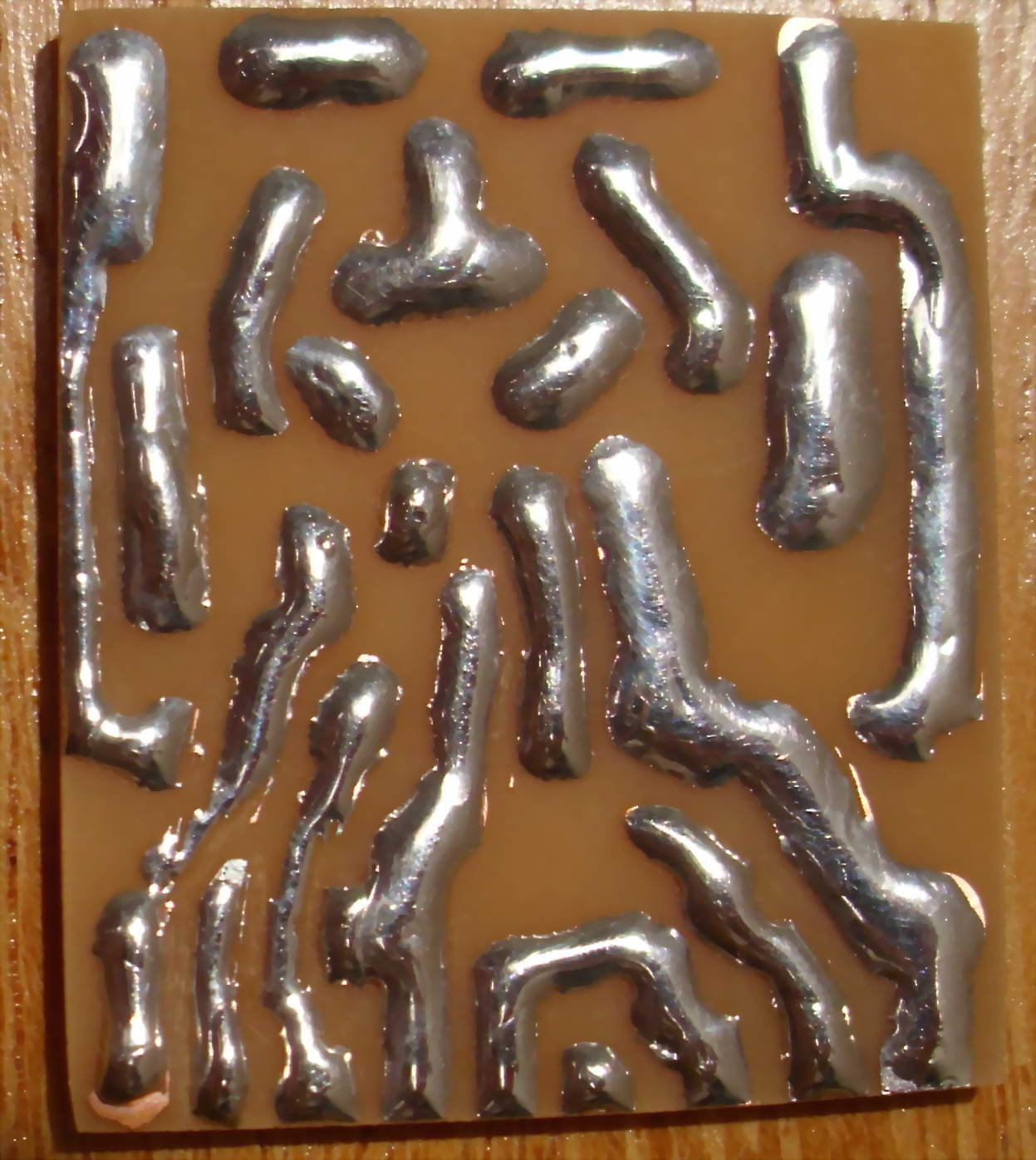

The small prototype board to Dx Super A is ready to solder
I will met Doctor to ask permission to be sitted for long time.
To the ones does not know uncle Charlie, this is to be soldered at the copper side...you see that solder was melted already, preparing the surface to easy accept component terminals... this method is easier, you can inspect the circuit while soldering...you have not the copper tracks in the other side needing transparency, or lamp below to watch lines...here, all copper lines (tracks) are there for you to see.
To produce prototype there's no better way...no bad contact as you have in protoboard, no mess of wires...if you try once, i am sure you will never try the other way to prototype, because it is the easiest and most practical way to do.... there are some simple skills needed...have to solder from the left to the right if you are right handed..doing this way, soldering iron tip will not burn component cases.
Of course, when ready, adjusted, passed...then you produce the standard board style, with holes, silk screen and whatever you want/need.... this is for prototype.

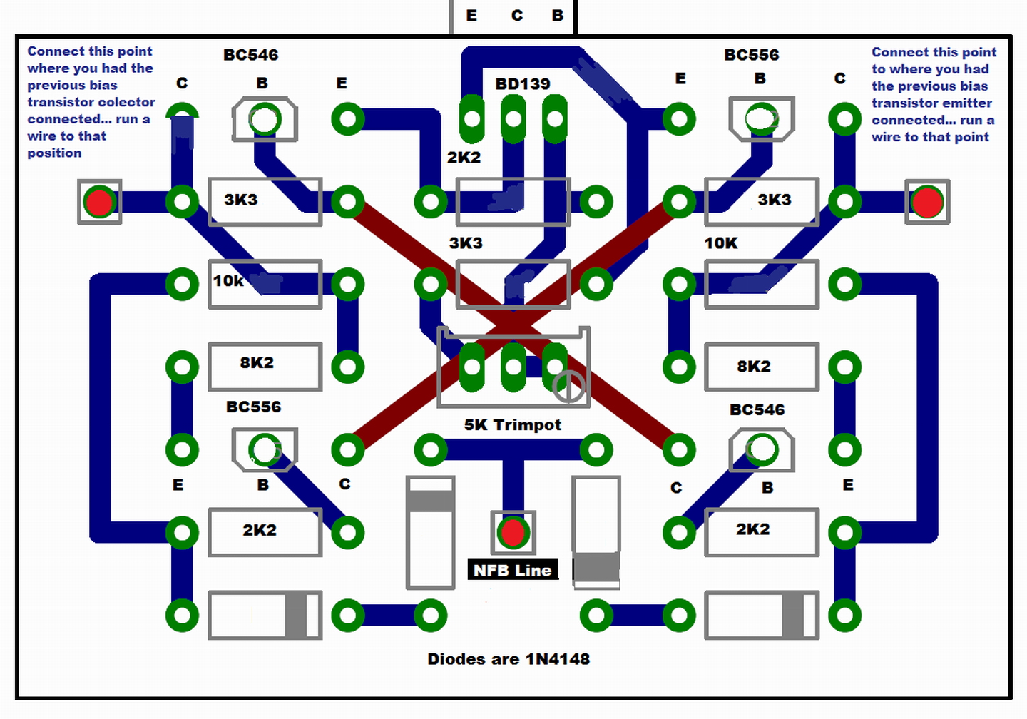

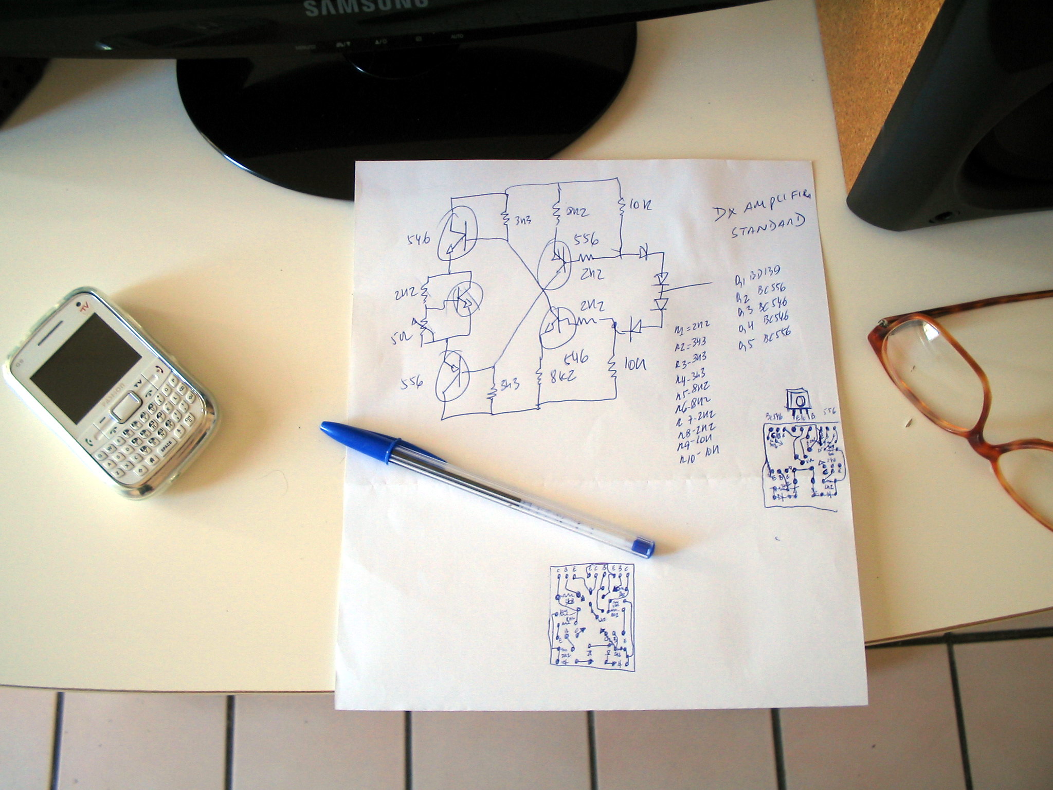

Please, do not build the Dx Super A module for a while..i have made a big mistake
I forgot important connections to the board that makes the circuit to operate dinamically...it was operating statically alike a bias trimpot.... no feedback was beeing readed and no dinamics biasing was actuating.
Because of that, please, wait further testings to assemble you unit.
Here you have a video informing what is going wrong...i forgot the X shape white wires you see...jumpers to the board i forgot:
Do not assemble Dx Super A for a while - YouTube
Next amplifier to be connected and tested together the Dx Super A module will be the Dx Blame ST..and them i will assemble the Dx amplifier to test together the standard unit.
regards,
Carlos
