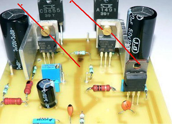

Pretty...very pretty construction...the best one made with Dx schematic
One day i will have a photo machine so good as yours.
Very good image with only 32K....very impressive your digital machine.
Tell me some about those heatsinks... are they enougth?
I was observing details... the screw positions are almost the same..perfect alignment of transistors.....very nice job.

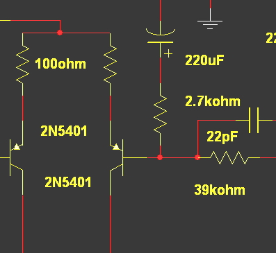

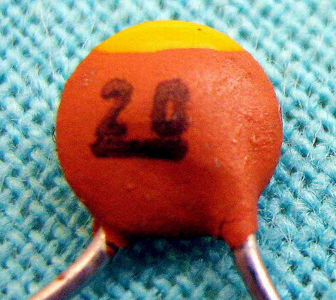

Please, i would be happy to know the meaning of this yellow mark here
Are there someone that can inform me.
Is this precision mark?
Voltage limit mark?
I have found this capacitor in a Japanese circuit...constructed around the eigthies.

Wakarimashita....thank you Jacco...you!...you!..you!
A very nice guy.
So des ne!... domo arigatô gosai mashita.
Tântalum?..... grumpf!!!!
I am kidding...very happy with your presence..the image is only to produce "noise"...this is atractive to many folks that loves to have some fun.

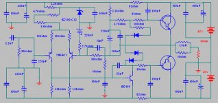

Wow, the heatsinks are pretty expensive!!!
Would 25V rails make it possible to use sinks more like the ones I posted... ? How many watts would that give into 8 ohms?
I think the sinks, the transformers, and those 8 rail caps will be very expensive all added together.... It better sound good, and not burn too many components while I set it up.
Also havein hard time getting the 2SA1943, can get 2 but I need to order Ex the UK... Do any transistors need to be matched - I need to know so that I can order enough?
Is the Tip41s better than bd139s.... the bd139 is only rated for 12W.?
Which transistor package should the Qs be? i.e. A B C.....?

Here is your answer Nordic.
My Word program is blocked....grrrrr!..so, i will try to attach wave pad file:
You power will be exactly 30 watts rms over 8 ohms
Your rail current will be 870 miliamperes.
Your off set will be near 1 milivolt with the off set
trimpot adjusted to 3380 ohms
If you decide to use VBE multiplier, the base to emitter
resistance will be 620 ohms (ajustable) and the base
to colector will be 1800 ohms (fixed one)
Over 4 ohms your power can be 60 watts rms...this
will depend from your supply...if it will hold those 25 Volts
or not...or...how many volts it will loose when hard drained
BD139 is vastly better than TIP41...but power there will not
be a problem.... use small aluminium heatsinks...for VAS
and for the drivers 15 milimeters sides for Vas... and make
a "L" shape from a 30 milimeters to 20 milimeters aluminium
to the drivers.
Matching is extremelly important to the input differential...but
Dx amplifier will work fine even using mismatched ones..the off
set adjustment will compensate a little that mismatch.
Also good for Drivers...also interesting to output...but difference
around 30 percent are not so bad in real world.
You can use TIP41/42 to your output..but only using 8 ohms ,
and having good heatsink..they will be near their limits and will
need to work not so hot.
Also TIP3055 and TIP2955 can be used for output...other TIP transistors
can be used too...also, the amplifier can be modified to accept
TIP142 and TIP147 if needed.(using 25 volts of even more)
Well...good...Wavepad worked fine here.
Observe that in the feedback line, you will need to replace a resistance..using the one show in the image supplied.
Also, do not worry with rail condensers...you can replace all them to 100uf..also your supply will work fine with 4700uf each rail
If you decide to use diodes to control the bias...use three units and a 150 ohms (adjustable) resistance in series with them...every silicon diode will fit...1N4148, 1N4001 and up.

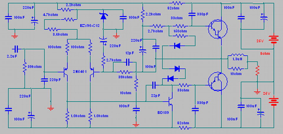

Here is a simulated version of the Dx amplifier...darlington version
Dx amplifier can be customized to your parts and your needs.
Just inform what you want.
This one is not the Standard, guaranteed version.
Just an option for darlington owners.
Related darlingtons.... you cannot tweak the internal resistances, this limits adjustments you can make on them...normally they distort more and "loves with passion" to oscilate.
I do not think they are a very good idea...but...you may have them...so...there's the option.
Include big condensers from the colector to the base in your darlingtons....TIP142 and TIP147 may hold the 50 watts amplifier, BUT using 8 ohms only...they are 100 watts maximum i think...so...will not be able to hold 4 ohms load using plus 35 and negative 35 (or another voltage around those)
Using 25 volts symetrical supply you may use 4 ohms....but will be dangerous, as will work sligtly over the limits...short life in this case i think.
This darlington version, absolutelly, is not guaranteed...do it under your own risk...was only simulated...real life may explode!
Yes!...a capacitor connecting those darlington bases is a good idea because those diodes..... 1uf, or more, will be good.

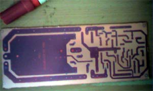

You can do your own board using hand work
Watching your schematic..... draw it over the copper....then...erase the components..keep the lines only.
Put it into the acid to corrode...then clean it and solder your parts directly over the copper lines.
You will be watching the circuit...made the same as the schematic.
Nothing can he more fast and more easy than that.

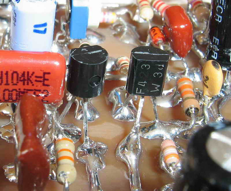

And this kind of construction is not so ugly as you may imagine
Depending the solder quality,..circuit lines can be made very interesting.
Solder in my country is not expensive....A pound of the Best one, will cost under 15 dollares (US dollar).
That solder brand is "Best" and has triple flux of solder resine inside de solder wire, 1 milimeters diameter and coiled over a plastic reel.
